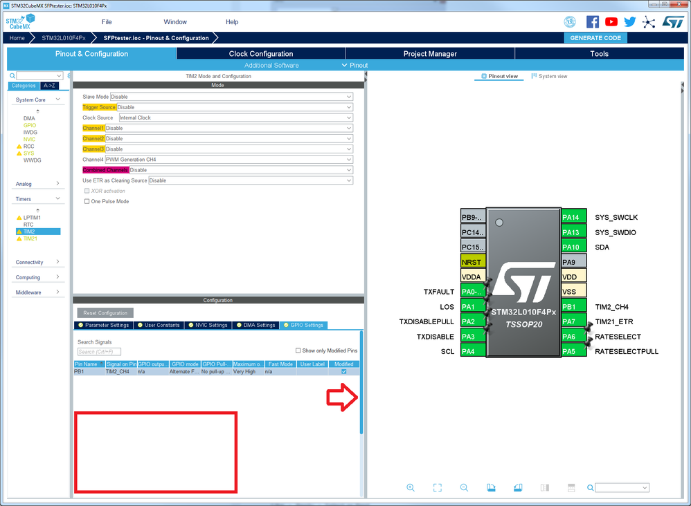

OSPEED was set to "LOW". Increasing it to "VERY HIGH" did the trick.
thank you
(STM32CubeMX hides it away - you have to scroll the option into view in order to notice that you can change this)
thank you
