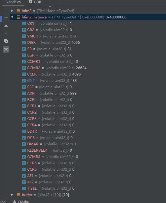

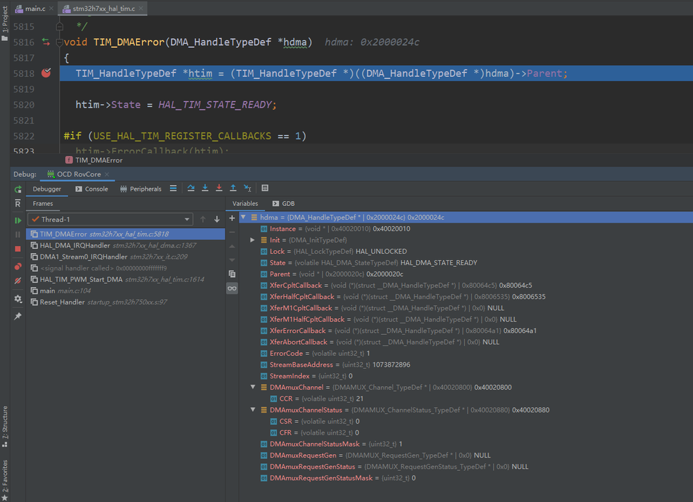

I passed the debugger and found that it fell into TIM_DMAError.
I observed that the value of ErrorCode for HDMA becomes 1, which is defined in stm32h7xx_hal_dma.h as
#define HAL_DMA_ERROR_TE (0x00000001U) /*!< Transfer error */

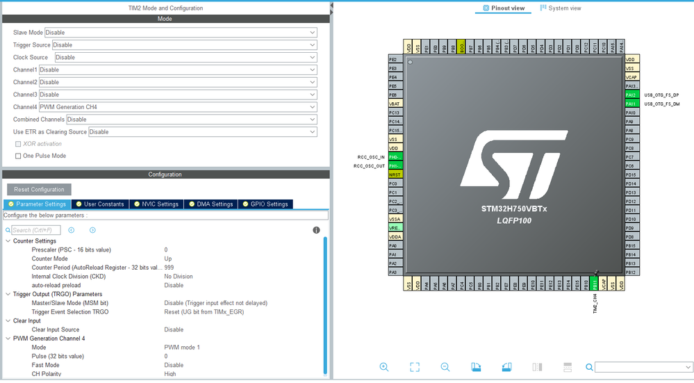

My cubemx configuration

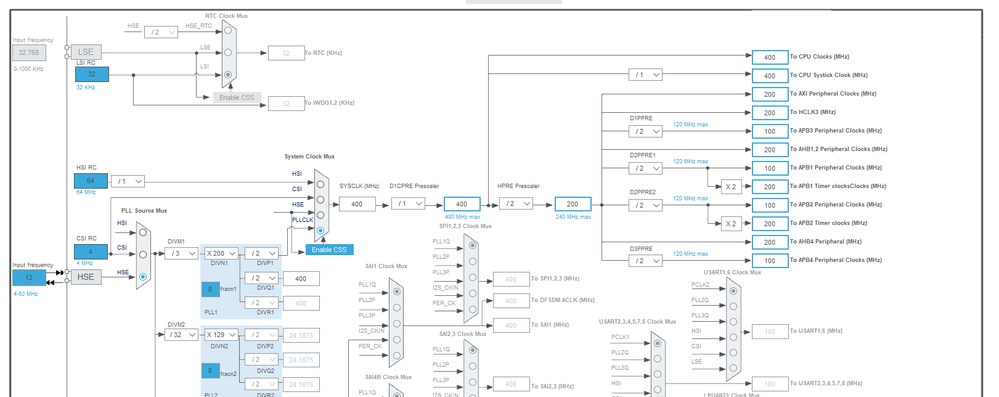

Clock
TIM

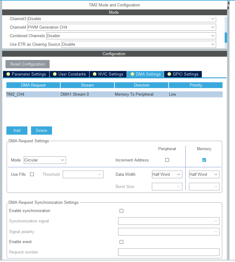

DMA

Pretty sure TIM2 is 32-bit wide, should use array of 32-bit ints, DMA to TIM is likely at 32-bit already, but then your CCRx > ARR, ie 0x00320032

I changed the buffer array to uint32_t. Then set the DMA data width to 32-bit(Word).
Try again.DMA still doesn't work, ErrorCode is still 1.TIM seems to work fine, I can see that CNT is changing.
