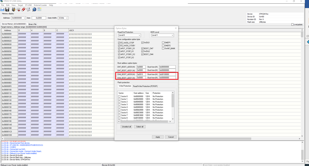

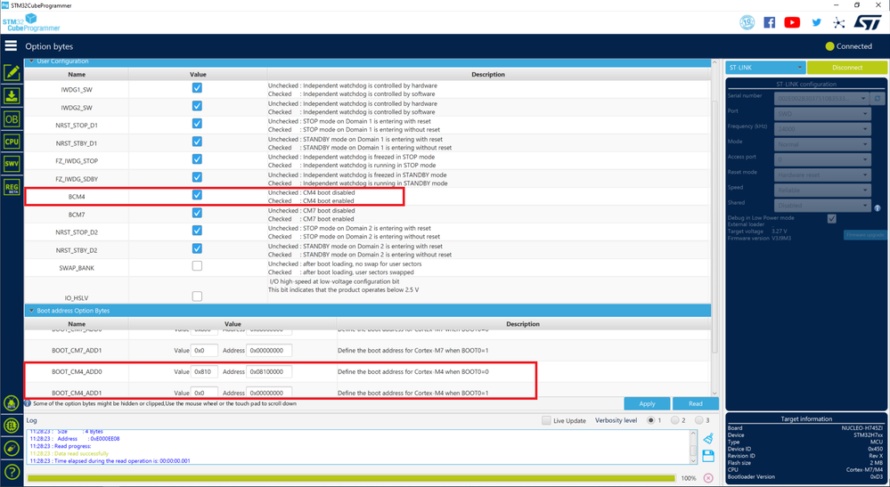

Please check this AN5286 on dual core debugging, it is very helpful. You can find in Section 5, MDK-ARM dual debugging.
About the BOOT_CM4 option bytes (BCM4) and CM4 boot address (BOOT_CM4_ADD0 and BOOT_CM4_ADD1), you can set them correctly using STM32CubeProgrammer.
At the moment BOOT_CM4_ADD0 and BOOT_CM4_ADD1 cannot be changed with CubeProgrammer. It is a known bug and the dev team is working on it.
So I advice you to connect your board with STLink Utility (a Legacy tool and now replaced by CubeProgrammer but still used and can be downloaded from this Link) and change the addresses.

is BOOT_CM4 enabled in option bytes? Is the CM4 code flashed and functioning correctly? Is the CM4 boot address set to where it needs to be?

Sara's response is good. There are a few things to be aware of and that post talk about it.
