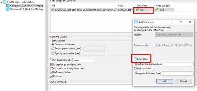

1- You need to set "Download" in CM4 debug configuration as following:

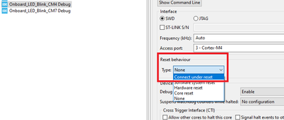

2- You need to set the reset behavior at least with: Connect under reset:

2024-03-16 6:55 AM - edited 2024-03-16 6:57 AM
Not easy to determine the source of the error but from the project you've already posted at the beginning:
I see two issues:

2024-03-16 1:27 PM - edited 2024-03-16 1:28 PM
Thanks this works. @mƎALLEm
