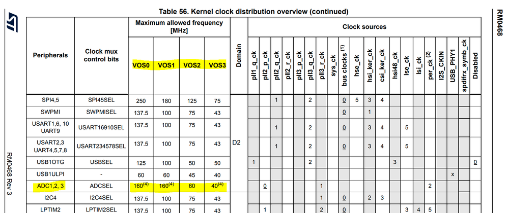

2022-02-16 9:29 AM
In the reference manual, "Table 56. Kernel clock distribution overview"
2022-02-16 9:35 AM
I currently have configured VOS1. Table 56 shows 160 Mhz limit with VOS1. How is this related to the limitation on Fadc that I experience? I get 126,5 MHz from PLL2P (which is below 160) and I'm not allowed to feed this divided only by 2 into f_adc_ker_ck_input, which (after another division by 2) would result in 31,5 MHz f_adc_ker_ck (which is below 160 and below 50). So there's still something I do not understand... Sorry...
