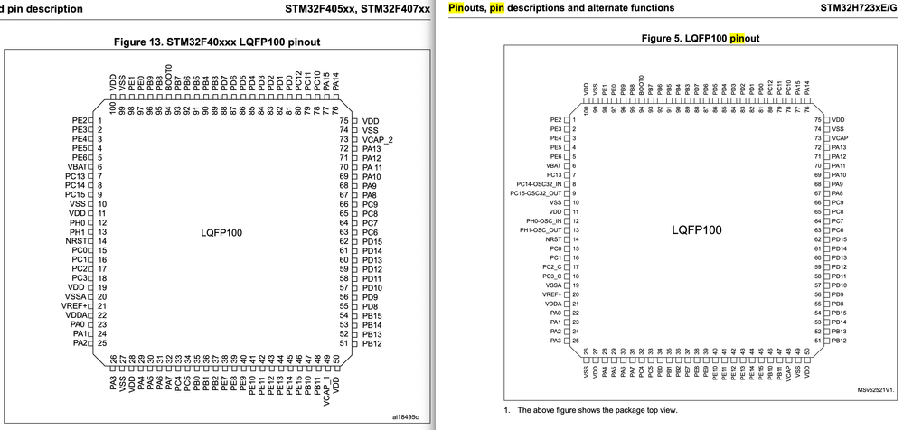

Please ignore - turns out STM32CubeMX hadn't updated properly. All working now. Thanks!
If anyone can explain why pins 19-48 are shifted along by one that would be wonderful though. So close to being a drop-in replaceable MCU to the previous one I designed for (now out of stock...). Oh for another respin...
