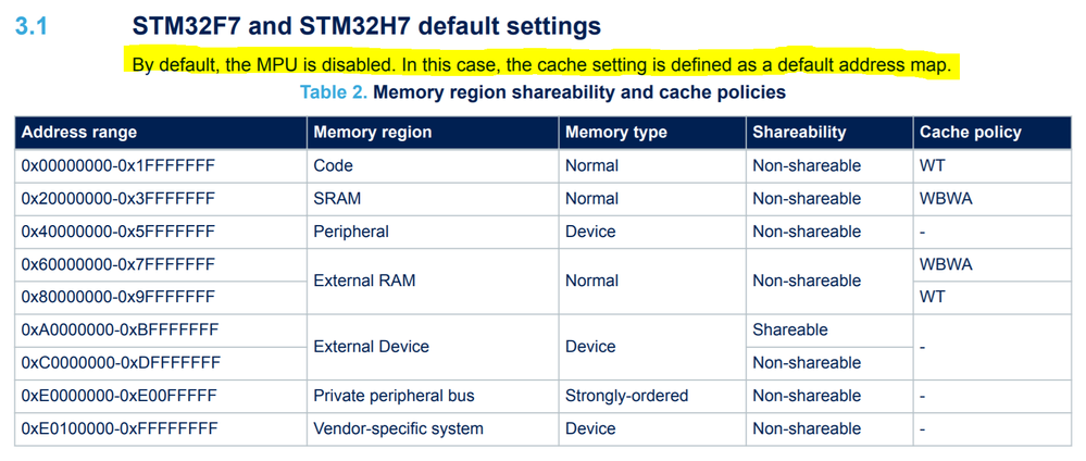

I'm using STM32H723, and STM32F767. CubeMX allows the data cache to be enabed and leave MPU disabled. Is this a valid configuration? Yes, i do know how to configure the MPU. Am i required to enable the MPU and configure all regions to have same attributes if i simply want the whole SRAM to be cacheable?
2021-01-04 5:50 PM
Yes.
No. SRAM is write-back write-allocate cached by default (at least on the H7). You can use the MPU to override this, but don't have to.
