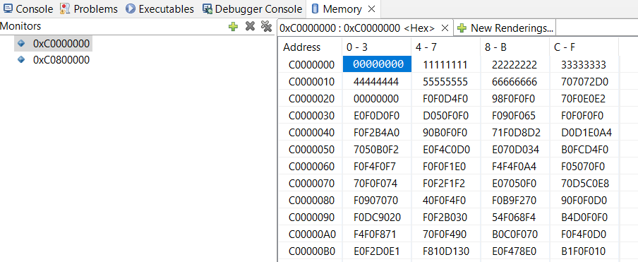

When I pause the program after initialization, I can use the memory viewer to view and modify memory at 0xC0000000 with no issues. However, when I hit any code that attempts to view or modify that same memory range I get a memory fault.
CFSR shows MMARVALID and DACCVIOL. MMFAR points to 0xC0000000.

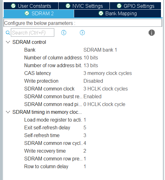

Here is my configuration:
SDRAM Init Function:
