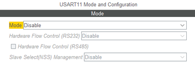

I can confirm, that for UART7 and USART6, the Checkbox "Hardware Flow Control (RS485)" is missing. For instance, this is how USART11 looks in my project, using the STM32H563RITx:

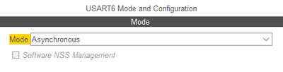

And this is USART6, which misses the HW-Flowcontrol configuration options:
