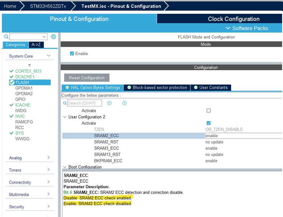

The description for SRAM2_ECC, SRAM3_ECC and BKPRAM_ECC, says the parameter in CubeMX needs to be set to “Disabled” to enable ECC check.

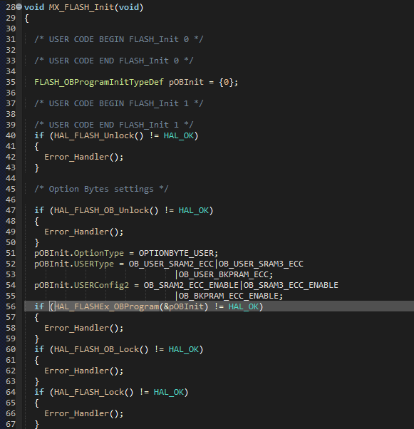

Assuming I want to disable ECC, I would set the option to “enable” in CubeMX. CubeMX then adds OB_SRAM2_ECC_ENABLE, OB_SRAM3_ECC_ENABLE and OB_BKPRAM_ECC_ENABLE in MX_FLASH_Init(). All three options are defined in stm32h5xx_hal_falsh_ex.h as 0. According to chapter 7.11.24 of the reference manual, setting the bit to 0 in the register, enables ECC (exactly the opposite of what I wanted). Therefore, the description in CubeMX is wrong. To Disable ECC, configure Disable in CubeMX and to enable ECC, configure enable.
