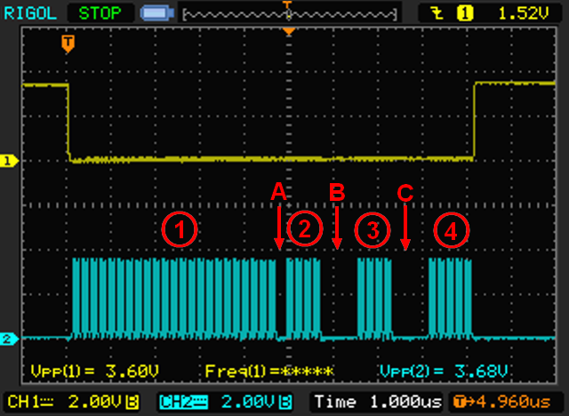

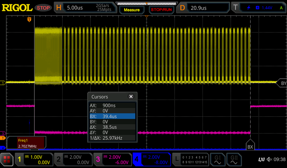

To analyze the issue I have reduced my test program to two calls: HAL_QSPI_Command and HAL_QSPI_Receive. There are no devices connected to the QSPI interface. I try to read 32 bytes, the CPU clock is set to 170MHz and the QSPI is working with 10MHz. On the oscilloscope I can observe the following behavior (yellow: QSPI_NCS, blue: QSPI_CLK):
0693W00000QN8mrQAD.bmpThere are 3 breaks in the clock generation: A, B and C (2 + 8 + 8 clocks). In the phases (1), (2), (3) and (4) the data will be transfered:
(1): 46 clocks = 8 (instruction) + 38 (19 data bytes)
(2): 8 clocks (4 data bytes)
(3): 8 clocks (4 data bytes)
(4): 10 clocks (5 data bytes)
The total number of transfered bytes (32) is correct. What is the reason for the breaks in the clock generation?

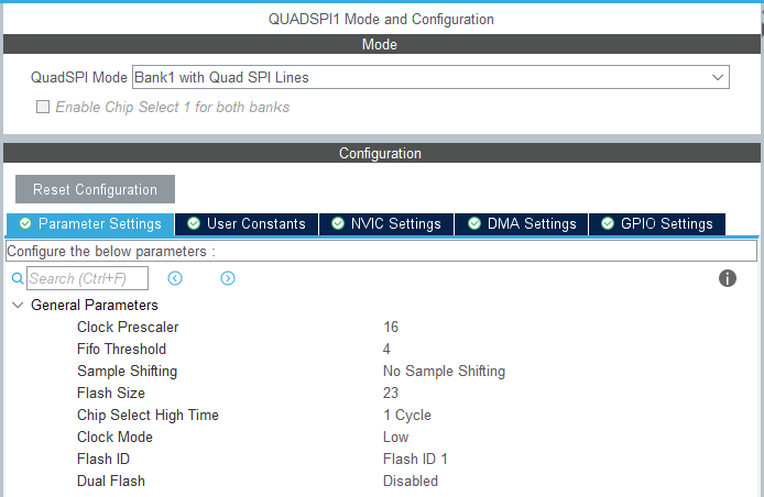

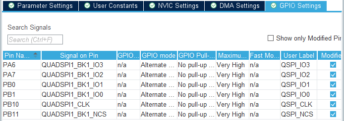

The QSPI has been configured as follows:
0693W00000QN8mwQAD.png0693W00000QN8n1QAD.pngKind regards

I have also tested the SPI/QSPI speed on STM32H755. The STM32H755 seems to have a similar problem.
Test conditions:
  •  hardware: NUCLEO-H755ZI-Q (core M7, 400 MHz), W25Q128JV
  •  software: STM32CubeMX 6.8.0, STM32Cube FW_H7 V1.11.0, MDK-ARM V5.36.0.0
  •  used HAL functions: HAL_QSPI_Command, HAL_QSPI_Receive
  •  used flash memory commands: Fast Read (0Bh), Fast Read Quad I/O (EBh)
Performed tests:

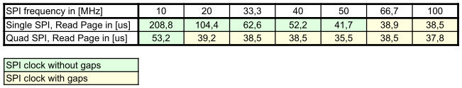

  •  read a flash memory page (256 Bytes) in single and quad modes with following SPI clock frequences: 10 MHz, 20 MHz, 33,3 MHz, 40 MHz, 50 MHz, 66,7 MHz and 100 MHz.
Test results:
  •  the table shows the read times for one flash memory page

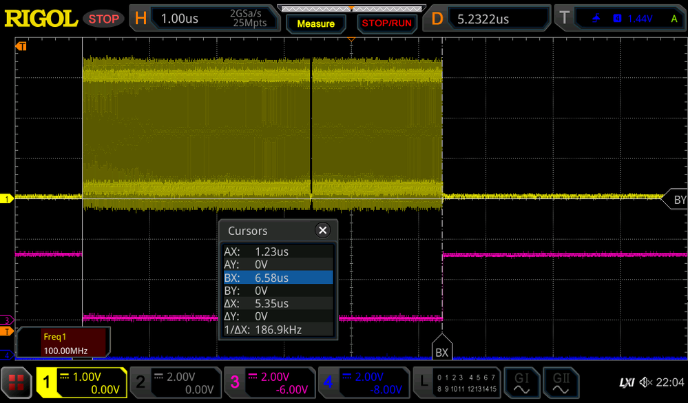

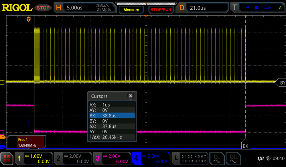

  •  the oscilloscope screenshots shows the NCS and CLK signals in single and quad modes at 100 MHz

@SStor: It was a very good idea. Thank you!
The issue is solved now. The screenshot shows a read of one flash page in quad mode at 100 MHz:
The command "Fast Read Quad I/O (EBh)" needs 532 SPI CLKs. The duration should be 5,32us, but there is a small gap of 3 CLKs after about 3,4us.
