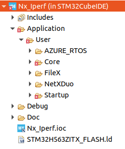

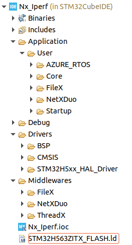

Original project structure:

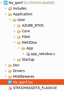

Structure after code has been regenerated:

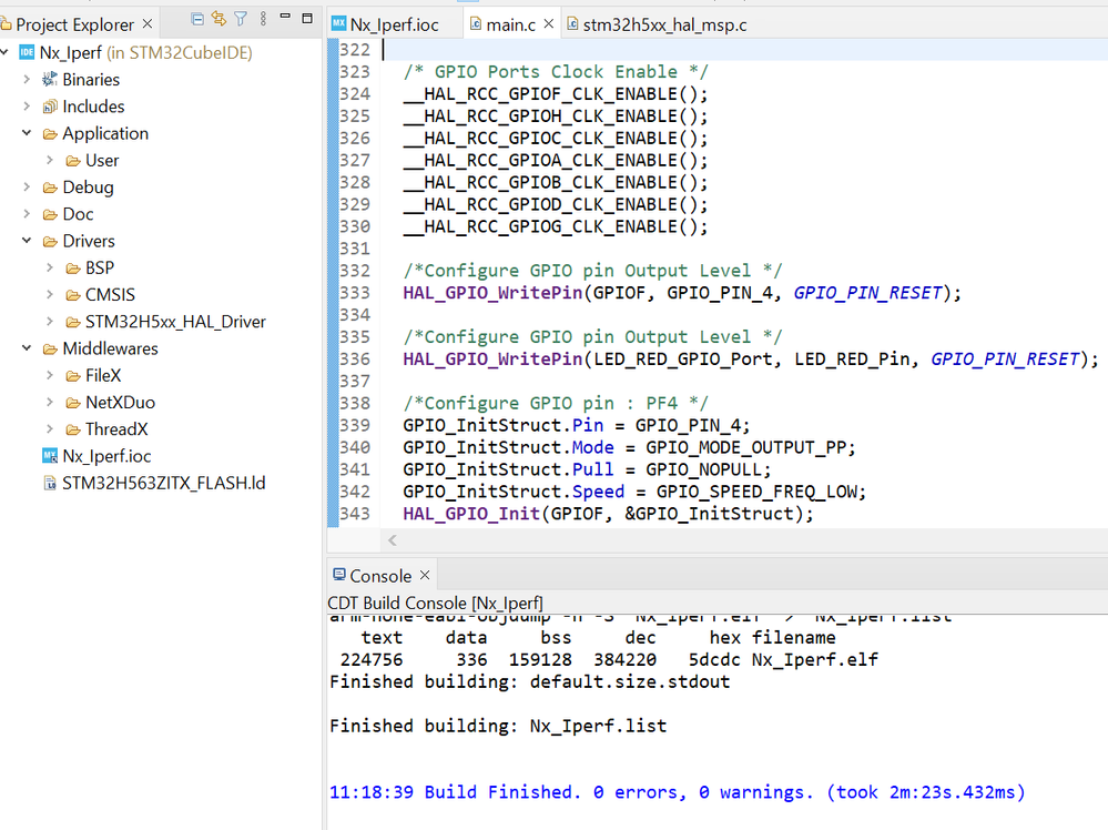

2023-03-22 12:04 PM
New structure:
2023-03-23 3:26 AM
Hello @Community member ,
After modification (add PF4 as GPIO output) , go to project manager -> Code generator :
Re-generate the code:
Hope I helped you!
Foued
2023-03-23 2:47 PM
Thank for testing. I retried with exactly same setting from code generator.
But finally Application/User/NetXDua/App/nx_iperf.c vanishes during code generation and the build process still fails.
I am running on ubuntu 20.04 host.
On disk the complete folder Middlewares/ST/netxduo/utility/) is missing after regeneration - may be more.

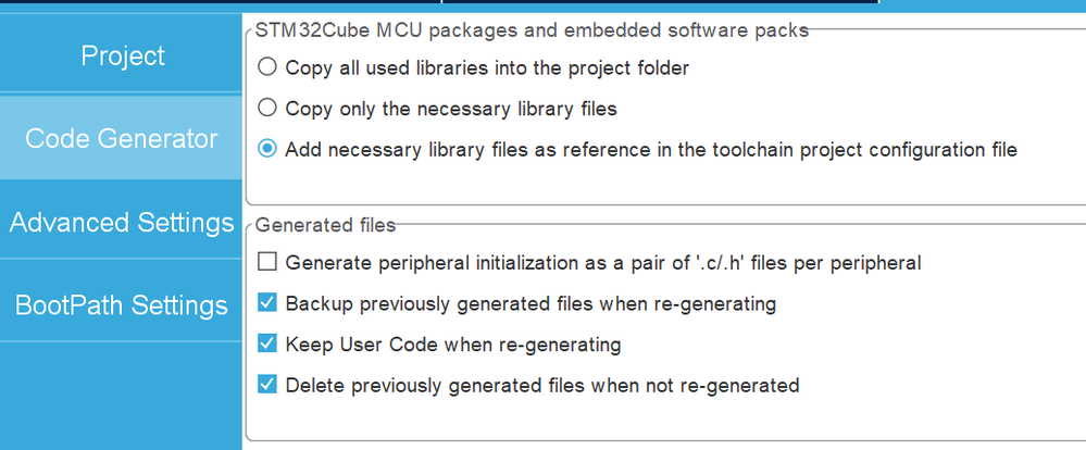

2023-03-24 4:04 AM
Could you try please to enable the " Backup previously generated files when re-generating "
Foued
2023-03-24 8:47 AM
This option was already switched on.
