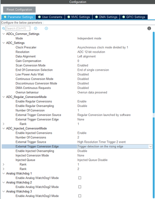

I am using hrtim to trigger the adc, but if the regular channel is not triggered with hrtim, it doesn't go into the interrupt of the ADC properly, I checked a lot of information and didn't find a solution, here is my code and cubemx configuration:

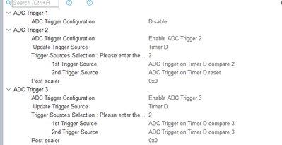

  LL_HRTIM_ConfigADCTrig(HRTIM1, LL_HRTIM_ADCTRIG_2, LL_HRTIM_ADCTRIG_UPDATE_TIMER_D, LL_HRTIM_ADCTRIG_SRC24_TIMDCMP2|LL_HRTIM_ADCTRIG_SRC24_TIMDRST);
  LL_HRTIM_SetADCPostScaler(HRTIM1, LL_HRTIM_ADCTRIG_2, 0x0);
  LL_HRTIM_ConfigADCTrig(HRTIM1, LL_HRTIM_ADCTRIG_3, LL_HRTIM_ADCTRIG_UPDATE_TIMER_D, LL_HRTIM_ADCTRIG_SRC13_TIMDCMP3|LL_HRTIM_ADCTRIG_SRC13_TIMDCMP3);
  LL_HRTIM_SetADCPostScaler(HRTIM1, LL_HRTIM_ADCTRIG_3, 0x0);

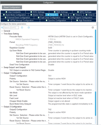

  LL_HRTIM_TIM_SetPrescaler(HRTIM1, LL_HRTIM_TIMER_A, LL_HRTIM_PRESCALERRATIO_DIV1);
  LL_HRTIM_TIM_SetCounterMode(HRTIM1, LL_HRTIM_TIMER_A, LL_HRTIM_MODE_CONTINUOUS);
  LL_HRTIM_TIM_SetPeriod(HRTIM1, LL_HRTIM_TIMER_A, (TIME_PERIOD));
  LL_HRTIM_TIM_SetRepetition(HRTIM1, LL_HRTIM_TIMER_A, 0x00);
  LL_HRTIM_TIM_SetUpdateGating(HRTIM1, LL_HRTIM_TIMER_A, LL_HRTIM_UPDATEGATING_INDEPENDENT);
  LL_HRTIM_TIM_SetCountingMode(HRTIM1, LL_HRTIM_TIMER_A, LL_HRTIM_COUNTING_MODE_UP_DOWN);
  LL_HRTIM_TIM_SetTriggeredHalfMode(HRTIM1, LL_HRTIM_TIMER_A, LL_HRTIM_TRIGHALF_DISABLED);
  LL_HRTIM_TIM_SetComp1Mode(HRTIM1, LL_HRTIM_TIMER_A, LL_HRTIM_GTCMP1_EQUAL);
  LL_HRTIM_TIM_SetRollOverMode(HRTIM1, LL_HRTIM_TIMER_A, LL_HRTIM_ROLLOVER_MODE_BOTH);
  LL_HRTIM_TIM_SetFaultEventRollOverMode(HRTIM1, LL_HRTIM_TIMER_A, LL_HRTIM_ROLLOVER_MODE_BOTH);
  LL_HRTIM_TIM_SetBMRollOverMode(HRTIM1, LL_HRTIM_TIMER_A, LL_HRTIM_ROLLOVER_MODE_BOTH);
  LL_HRTIM_TIM_SetADCRollOverMode(HRTIM1, LL_HRTIM_TIMER_A, LL_HRTIM_ROLLOVER_MODE_BOTH);
  LL_HRTIM_TIM_SetOutputRollOverMode(HRTIM1, LL_HRTIM_TIMER_A, LL_HRTIM_ROLLOVER_MODE_BOTH);
  LL_HRTIM_TIM_SetDACTrig(HRTIM1, LL_HRTIM_TIMER_A, LL_HRTIM_DACTRIG_NONE);
  LL_HRTIM_TIM_DisableHalfMode(HRTIM1, LL_HRTIM_TIMER_A);
  LL_HRTIM_TIM_SetInterleavedMode(HRTIM1, LL_HRTIM_TIMER_A, LL_HRTIM_INTERLEAVED_MODE_DISABLED);
  LL_HRTIM_TIM_DisableStartOnSync(HRTIM1, LL_HRTIM_TIMER_A);
  LL_HRTIM_TIM_DisableResetOnSync(HRTIM1, LL_HRTIM_TIMER_A);
  LL_HRTIM_TIM_EnablePreload(HRTIM1, LL_HRTIM_TIMER_A);
  LL_HRTIM_TIM_SetUpdateTrig(HRTIM1, LL_HRTIM_TIMER_A, LL_HRTIM_UPDATETRIG_NONE|LL_HRTIM_UPDATETRIG_REPETITION|LL_HRTIM_UPDATETRIG_RESET);
  LL_HRTIM_TIM_SetResetTrig(HRTIM1, LL_HRTIM_TIMER_A, LL_HRTIM_RESETTRIG_NONE);
  LL_HRTIM_TIM_DisablePushPullMode(HRTIM1, LL_HRTIM_TIMER_A);
  LL_HRTIM_TIM_DisableDeadTime(HRTIM1, LL_HRTIM_TIMER_A);
  LL_HRTIM_TIM_EnableFault(HRTIM1, LL_HRTIM_TIMER_A, LL_HRTIM_FAULT_2);
  LL_HRTIM_TIM_SetBurstModeOption(HRTIM1, LL_HRTIM_TIMER_A, LL_HRTIM_BURSTMODE_MAINTAINCLOCK);
  LL_HRTIM_ForceUpdate(HRTIM1, LL_HRTIM_TIMER_A);
  LL_HRTIM_TIM_DisableResyncUpdate(HRTIM1, LL_HRTIM_TIMER_A);
  LL_HRTIM_TIM_SetCompare1(HRTIM1, LL_HRTIM_TIMER_A, (Duty_cycle));
  LL_HRTIM_TIM_SetCompareMode(HRTIM1, LL_HRTIM_TIMER_A, LL_HRTIM_COMPAREUNIT_2, LL_HRTIM_COMPAREMODE_REGULAR);
  LL_HRTIM_TIM_SetCompare2(HRTIM1, LL_HRTIM_TIMER_A, (Duty_cycle));
  LL_HRTIM_OUT_SetPolarity(HRTIM1, LL_HRTIM_OUTPUT_TA1, LL_HRTIM_OUT_POSITIVE_POLARITY);
  LL_HRTIM_OUT_SetOutputSetSrc(HRTIM1, LL_HRTIM_OUTPUT_TA1, LL_HRTIM_OUTPUTSET_TIMCMP1);
  LL_HRTIM_OUT_SetOutputResetSrc(HRTIM1, LL_HRTIM_OUTPUT_TA1, LL_HRTIM_OUTPUTRESET_TIMCMP1);
  LL_HRTIM_OUT_SetIdleMode(HRTIM1, LL_HRTIM_OUTPUT_TA1, LL_HRTIM_OUT_NO_IDLE);
  LL_HRTIM_OUT_SetIdleLevel(HRTIM1, LL_HRTIM_OUTPUT_TA1, LL_HRTIM_OUT_IDLELEVEL_INACTIVE);
  LL_HRTIM_OUT_SetFaultState(HRTIM1, LL_HRTIM_OUTPUT_TA1, LL_HRTIM_OUT_FAULTSTATE_INACTIVE);
  LL_HRTIM_OUT_SetChopperMode(HRTIM1, LL_HRTIM_OUTPUT_TA1, LL_HRTIM_OUT_CHOPPERMODE_DISABLED);
  LL_HRTIM_OUT_SetPolarity(HRTIM1, LL_HRTIM_OUTPUT_TA2, LL_HRTIM_OUT_POSITIVE_POLARITY);
  LL_HRTIM_OUT_SetOutputSetSrc(HRTIM1, LL_HRTIM_OUTPUT_TA2, LL_HRTIM_OUTPUTSET_TIMCMP2);
  LL_HRTIM_OUT_SetOutputResetSrc(HRTIM1, LL_HRTIM_OUTPUT_TA2, LL_HRTIM_OUTPUTRESET_TIMCMP2);
  LL_HRTIM_OUT_SetIdleMode(HRTIM1, LL_HRTIM_OUTPUT_TA2, LL_HRTIM_OUT_NO_IDLE);
  LL_HRTIM_OUT_SetIdleLevel(HRTIM1, LL_HRTIM_OUTPUT_TA2, LL_HRTIM_OUT_IDLELEVEL_INACTIVE);
  LL_HRTIM_OUT_SetFaultState(HRTIM1, LL_HRTIM_OUTPUT_TA2, LL_HRTIM_OUT_FAULTSTATE_INACTIVE);
  LL_HRTIM_OUT_SetChopperMode(HRTIM1, LL_HRTIM_OUTPUT_TA2, LL_HRTIM_OUT_CHOPPERMODE_DISABLED);

	while(HAL_ADCEx_Calibration_Start(&hadc2,ADC_SINGLE_ENDED)!=HAL_OK);
	HAL_ADC_Start_IT(&hadc2);
	HAL_ADC_PollForConversion(&hadc2, 50);
	LL_HRTIM_EnableIT_FLT2(HRTIM1);
	LL_HRTIM_EnableIT_UPDATE(HRTIM1,LL_HRTIM_TIMER_C);
	LL_HRTIM_TIM_CounterEnable(HRTIM1, LL_HRTIM_TIMER_MASTER | LL_HRTIM_TIMER_A | LL_HRTIM_TIMER_B | LL_HRTIM_TIMER_C | LL_HRTIM_TIMER_D);
#include "adc.h"
/* USER CODE BEGIN 0 */
/* USER CODE END 0 */
ADC_HandleTypeDef hadc2;
  hadc2.Instance = ADC2;
  hadc2.Init.ClockPrescaler = ADC_CLOCK_ASYNC_DIV4;
  hadc2.Init.Resolution = ADC_RESOLUTION_12B;
  hadc2.Init.DataAlign = ADC_DATAALIGN_RIGHT;
  hadc2.Init.GainCompensation = 0;
  hadc2.Init.ScanConvMode = ADC_SCAN_ENABLE;
  hadc2.Init.EOCSelection = ADC_EOC_SEQ_CONV;
  hadc2.Init.LowPowerAutoWait = DISABLE;
  hadc2.Init.ContinuousConvMode = DISABLE;
  hadc2.Init.NbrOfConversion = 1;
  hadc2.Init.DiscontinuousConvMode = DISABLE;
  hadc2.Init.ExternalTrigConv = ADC_EXTERNALTRIG_HRTIM_TRG3;
  hadc2.Init.ExternalTrigConvEdge = ADC_EXTERNALTRIGCONVEDGE_RISING;
  hadc2.Init.DMAContinuousRequests = DISABLE;
  hadc2.Init.Overrun = ADC_OVR_DATA_PRESERVED;
  hadc2.Init.OversamplingMode = DISABLE;
  if (HAL_ADC_Init(&hadc2) != HAL_OK)
    Error_Handler();
  sConfigInjected.InjectedChannel = ADC_CHANNEL_2;
  sConfigInjected.InjectedRank = ADC_INJECTED_RANK_1;
  sConfigInjected.InjectedSamplingTime = ADC_SAMPLETIME_247CYCLES_5;
  sConfigInjected.InjectedSingleDiff = ADC_SINGLE_ENDED;
  sConfigInjected.InjectedOffsetNumber = ADC_OFFSET_NONE;
  sConfigInjected.InjectedOffset = 0;
  sConfigInjected.InjectedNbrOfConversion = 2;
  sConfigInjected.InjectedDiscontinuousConvMode = DISABLE;
  sConfigInjected.AutoInjectedConv = DISABLE;
  sConfigInjected.QueueInjectedContext = DISABLE;
  sConfigInjected.ExternalTrigInjecConv = ADC_EXTERNALTRIGINJEC_HRTIM_TRG2;
  sConfigInjected.ExternalTrigInjecConvEdge = ADC_EXTERNALTRIGINJECCONV_EDGE_RISING;
  sConfigInjected.InjecOversamplingMode = DISABLE;
  /** Configure Injected Channel
  sConfigInjected.InjectedChannel = ADC_CHANNEL_14;
  sConfigInjected.InjectedRank = ADC_INJECTED_RANK_2;
  if (HAL_ADCEx_InjectedConfigChannel(&hadc2, &sConfigInjected) != HAL_OK)
    Error_Handler();
  /** Configure Regular Channel

Thank you in advance.
1 REPLY 1
ST_Sophia
Could you check please if sampling time you are using is enough to end the sampling and convertion in the same period before a new trigger:
I noticed from the code, that you programmed also a trigger3 in ADC but the event related in hrtim is not enabled (CMP3). This is for regular conversion.
Best regards.
