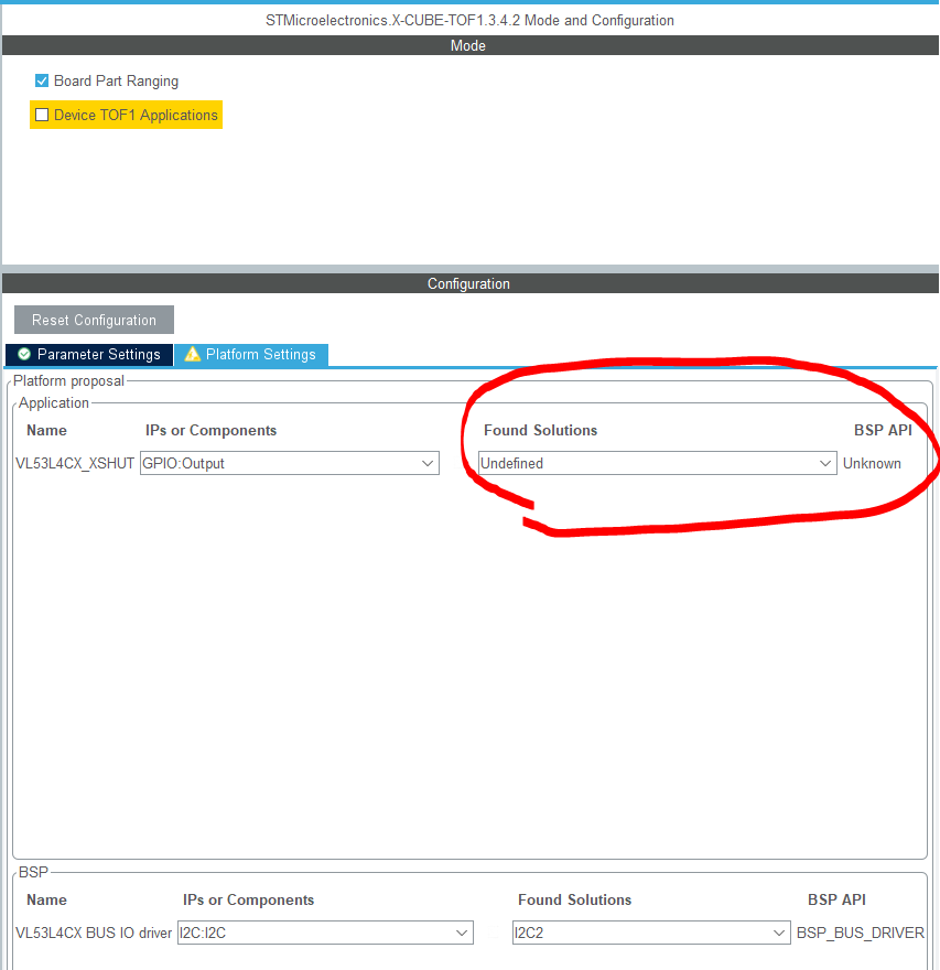

Attempting to add the X-CUBE-TOF1 middleware with the VL53L4CX sensor to our projects in CubeMX v6.14.0 currently fails. STM32CubeMX either permanently freezes or generates invalid code and references, even when inserted into a fresh project. We had to reinstall CubeMX and revert all changes to a prior state to get it unstuck.

Of note: when trying to configure the GPIO pin, we have simply tied XSHUT to VCC with a resistor. So we don't want or need GPIO control of this pin. But the configuration software gets hung on this I suppose.
