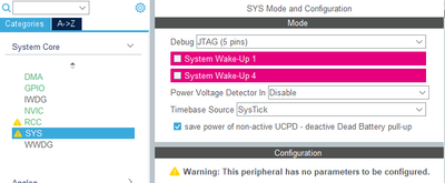

I realized even though STM32G431KB data sheet says it has VREF buffer inside, there is no option/menu for selecting VREFBUF in STM32CubeIDE.

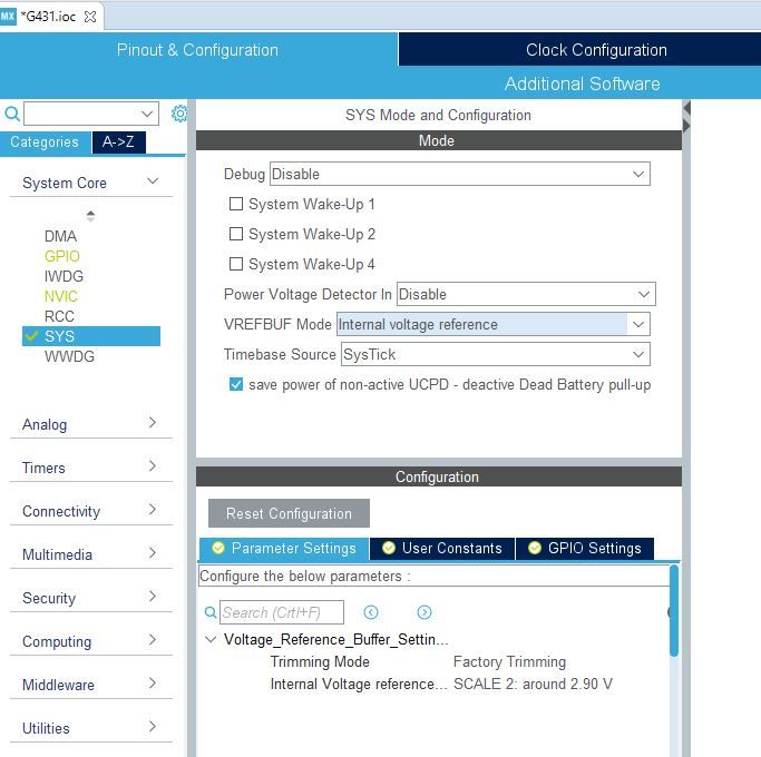

Please share your ioc file for check and precise which version of CubeMX/CubeIDE are you using.
Do you mean that you do not have the "VREFBUF mode" option as mentioned in the screenshot ?

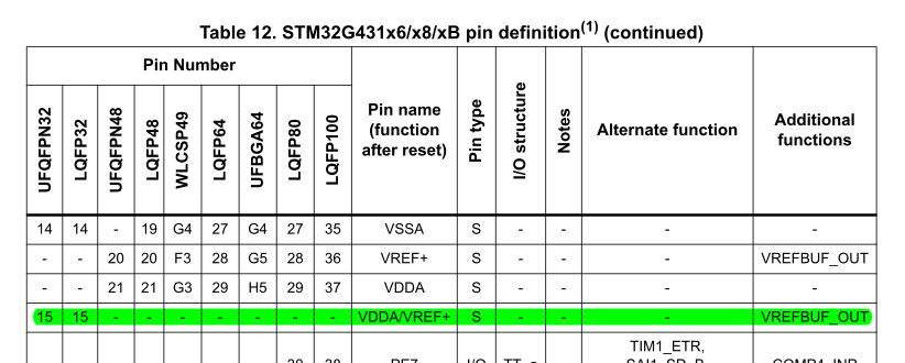

2020-03-30 11:15 PM
My version is 1.3.0 and Build: 5720_20200220_1053. Datasheet says that it does not have dedicated Vref+ pin in my package (32 pin) which is smallest. It is probably due to this. If I try larger package like 48 pin it has the VREFBUF option.
2020-03-30 11:16 PM
Yes, I do not have the option VREFBUF Mode like you show in screenshot.
2020-03-31 2:07 AM
In fact, when the VREF+ pin is double-bonded with VDDA pin in a package, the voltage reference buffer is not available and must be kept disabled

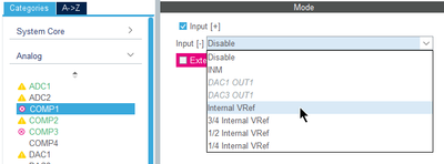

I want to use VREF as a reference with analog comparators on an STM32G431KBU3.
In CubeMX v6.13.0, there is no option to select VREF voltage:
but there are options to select (fractions of) VRef with the comparators:
Is it supposed to work (it does compile and link), when VREF is configured and enables using the HAL functions:
