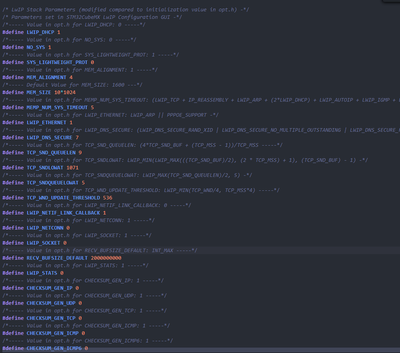

Now open the file at LWIP/Target/lwipopts.h
Note that at approximately line 58/59 there is:
/*----- Default Value for F7/H7 devices: 0x30044000 -----*/
#define LWIP_RAM_HEAP_POINTER 0x30004000
FIrst of all the comment doesn't match the value given, and even if you change the value given to the same as the comment (this is an F7 device after all) the code will still hard-fault.
If you comment out the #define the code will now build and run, but the number of ETH_RX_BUFFER_CNT buffers you can set in the IOC editor is very limited.
Also, if you make any changes at all to anything in the IOC editor, this line will get put back i and your code will hard-fault again.

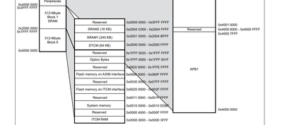

Hello @KMill, you are right
The default value causes a Hardfault as the address is in a reserved region:
I'm creating an internal ticket to correct this (Internal ticket number: 200083)

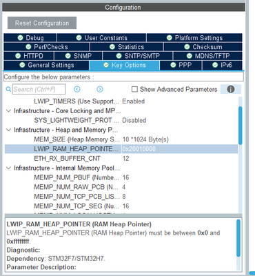

thanks for saving my day, I'm using STM32CubeMX version '6.13.0' to generate code and got the error as you said above, I wonder if ST has fixed that error or has a guide because it's very inconvenient every time I generate code again.
and one thing I just discovered is that previous versions of STM32CubeMX don't seem to generate anything similar to #define LWIP_RAM_HEAP_POINTER 0x30004000
UPDATE: I found a way to fix this problem, just change the address of LWIP_RAM_HEAP_POINTER to sram
2025-01-10 2:09 AM
I too changed the value in that field to 0x20010000 (sram) but I was not confident in the fix, having drilled through the macros that LWiP uses.
