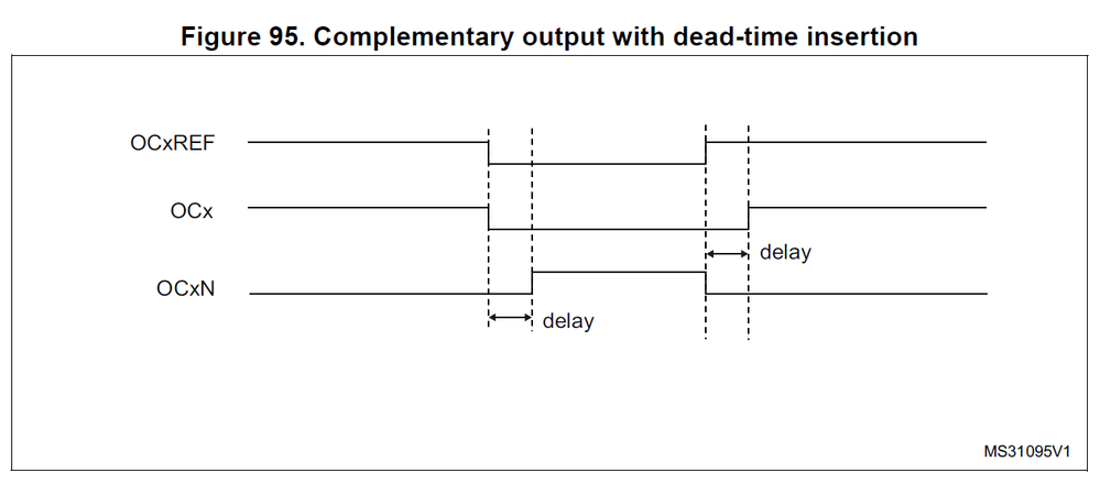

The STM32G0 has dead time insertion on the advanced timers (TIM1).

There is a break pin and channel. See the reference manual for the details.
