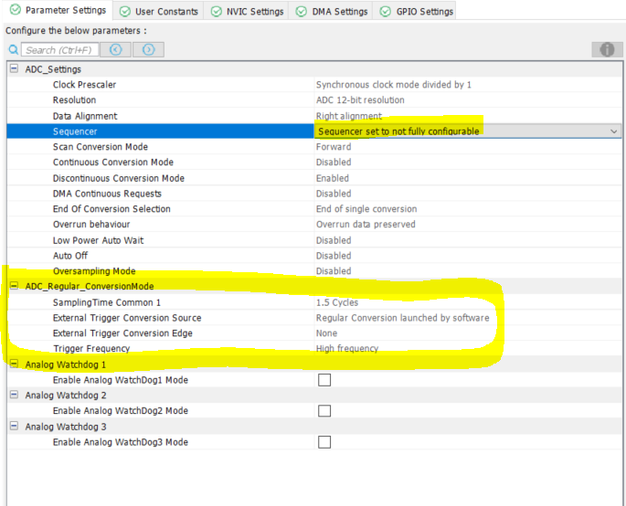

from rm :
so set > Sequencer -> not fully conf. ...
then can set all channels, not only up to 8 in sequence.

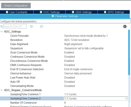

2023-07-05 5:33 AM - edited 2023-07-05 5:42 AM
if i change Sequencer then i would not have any more number o conversions to determine channels

method one: i already configured for 10 analog pins.. i can not undrestand why should i configure it for 2 pins???
Second metod: it is not possible because the maximum amount of conversions is 8

2023-07-06 7:06 AM
You can't sequence all 10 channels at once. You'll need to set it up to convert only 1 channel (CHSELRMOD=0) and change that channel after each conversion is complete.
