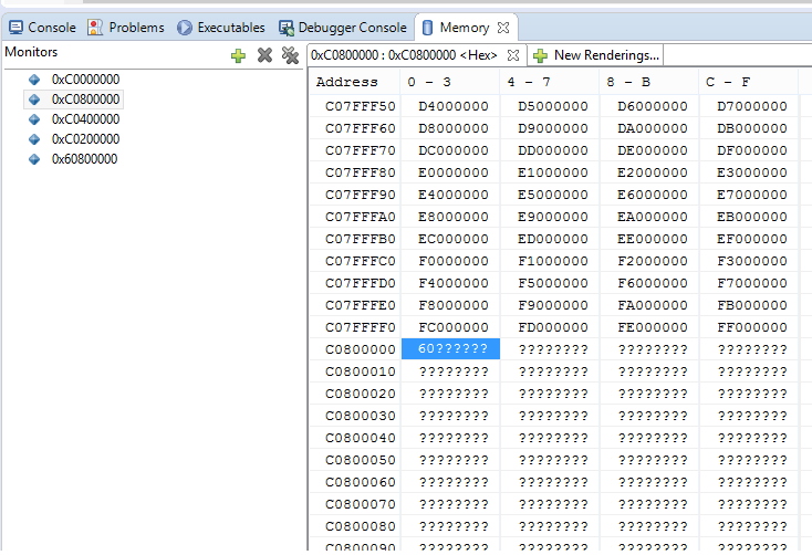

2020-11-07 1:56 PM
Hi!
I'm facing the same problem with the memory access above 0xC080 0000:
The difference is, that I'm already using a 32bit variables to write and read from the SDRAM.
uint32_t RxBuffer[SDRAM_TEST_BUFFER_SIZE], TxBuffer[SDRAM_TEST_BUFFER_SIZE];Do you have any hints what I can still check?

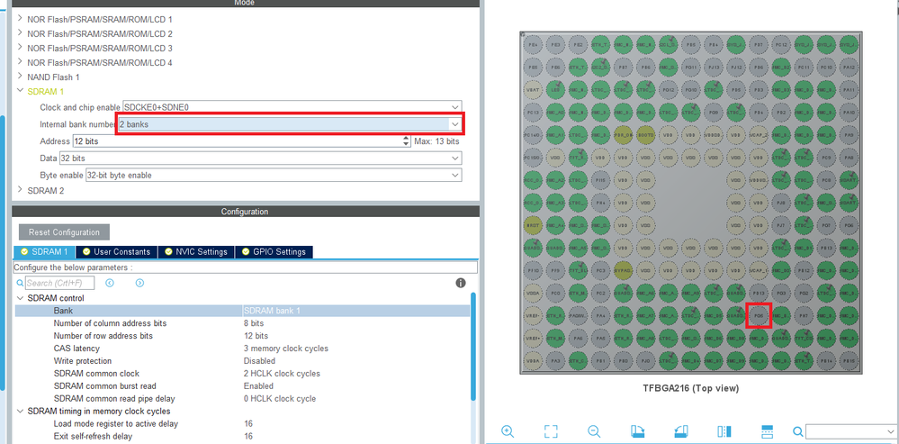

2020-11-08 3:10 AM
Hi FGeig.1 !
Yes, when I write data into the SDRAM, read out and compare, then I get a 1:1 match.
After attempt to write above 0xC080 0000 I get a HW fault.
Now I have tried to reduce the configuration to 2 banks and the result is the same:
When do this, then the BA1 pin (PG5) is deconfigured in the pin overview:
In the configuration of the fmc.c I can see the bank pins:
