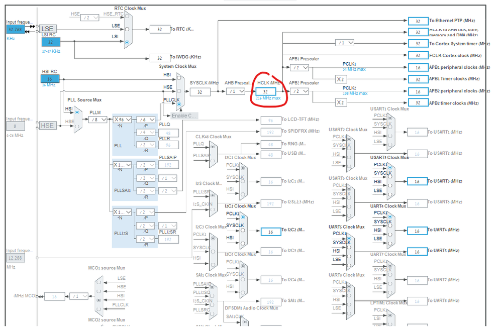

The clock tree:
The number we are changing is marked in red.
The consumption is about 104 mA regardless of the clock speed, and the power consumption simulator shows that we should get around 12-20 mA.

2022-10-26 3:39 AM
Seems like an excessive amount of current. You're powering something else here, or something else is wrong on the circuit.
