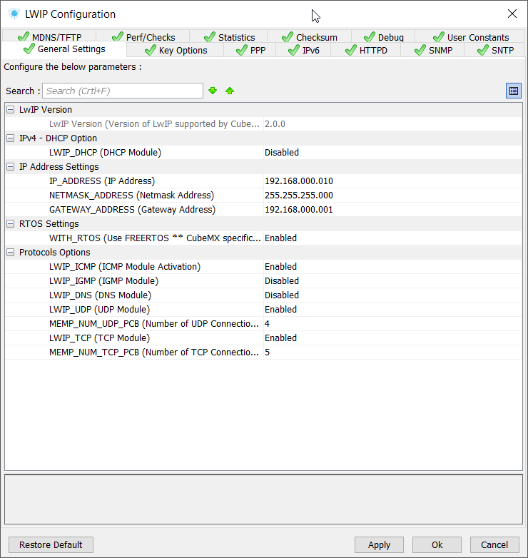

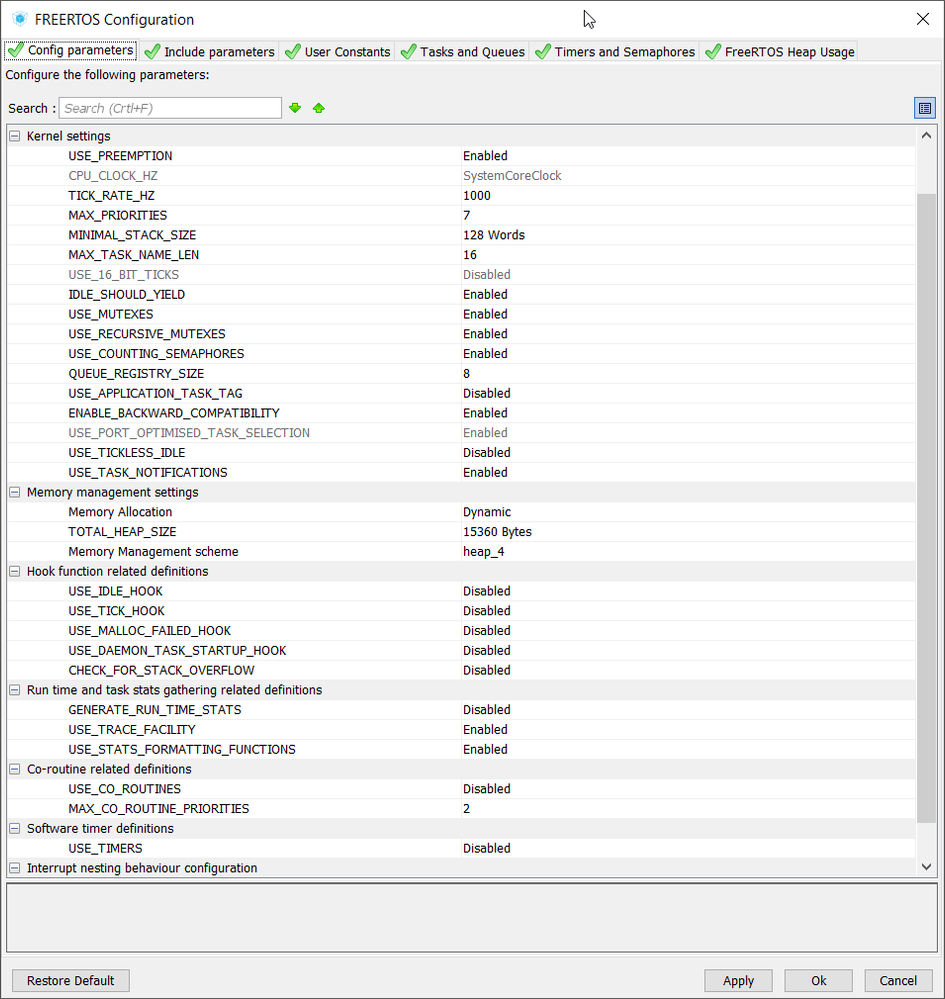

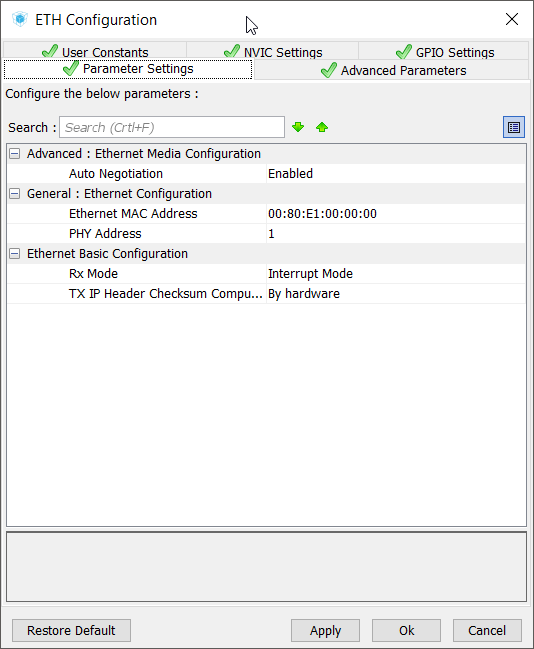

Im new to working on LwIP and I want to create a simple Webserver based on LwIP stack and FreeRTOS configured by the CubeMX. I read carefully all the user manual. I also tried to run and digged into the Netconn HTTP server example, but I still couldnt make it work!
I guess my configurations in the CubeMX has problems, so I post them here, if anyone have successfully worked on this project can help me, if possible could I have your .ioc file to study more about my problem ?

My ETH config
LwIP config. I disabled HTTPD feature.
This is my FreeRTOS configs
