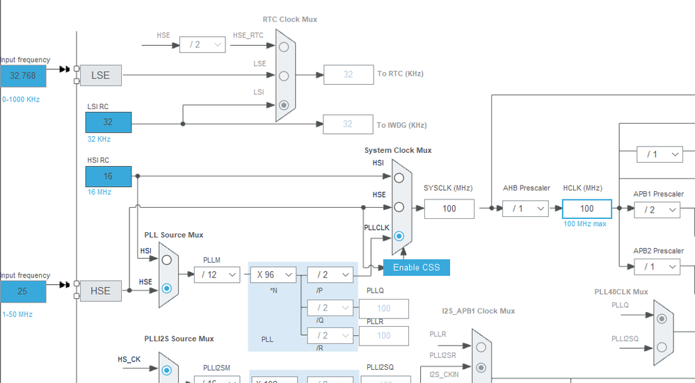

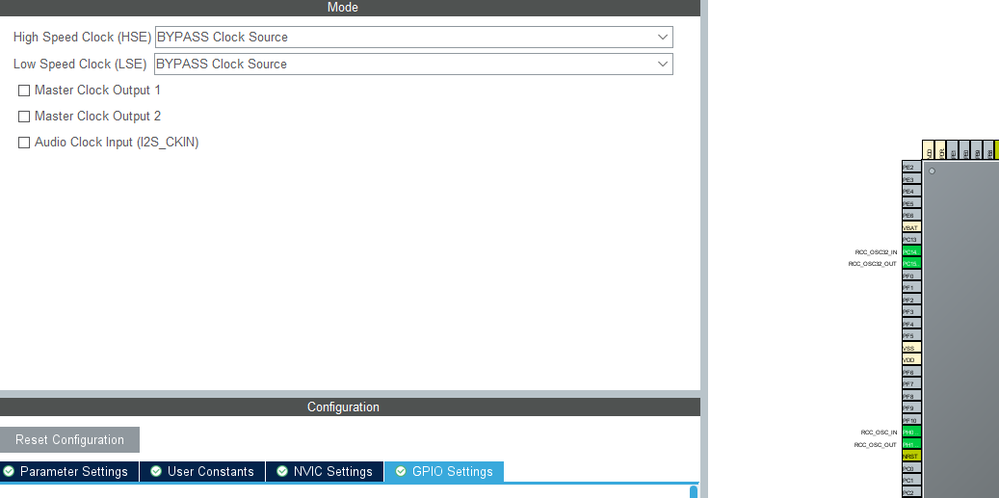

After setting RCC and Clock configuration as below, if you run the program, it moves to Error_Handler.
ECS-250-10-33B and ECS-327-34B
What is the problem?

As you're using SMD crystals, please try "Crystal/Ceramic resonator" instead of "BYPASS clock source".
