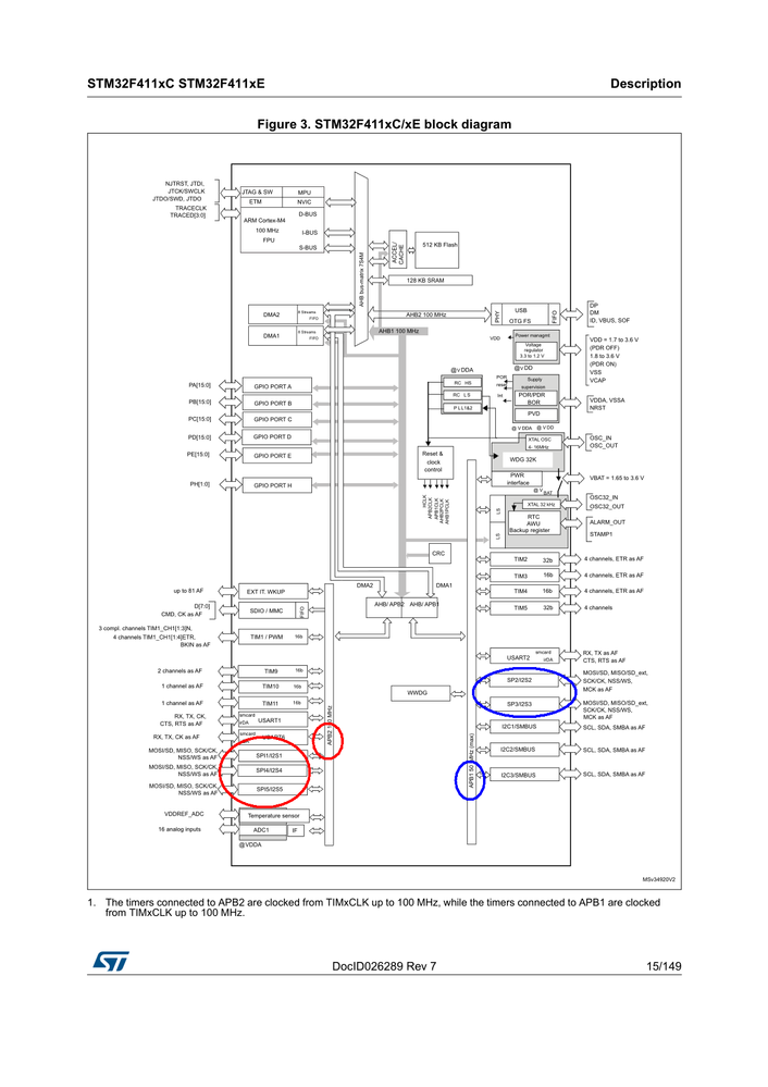

Even if in slave mode you may not need any particular APB clock to shift the data in, at high SKC-to-APB-clock ratios you won't be able to read the incoming data timely.
2022-01-16 10:55 AM
Thank you Jan, your 1st screenshot from the datasheet is the direct answer. I didn't check the MCU block diagram as I didn't expect such level of details for each peripheral. Apparently I underestimated the level of details in STM docs (pun intended). This diagram shows all the clock sources for all the peripherals. Very good.

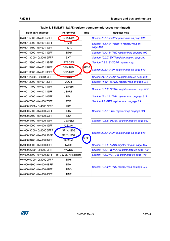

As for the 2nd screenshot from user manual - I would never expect to look for the peripheral clock sources in the memory map section. Sure, for those who know how MCU is built and how components interconnect internally , this might be obvious, but the app developer who only cares 'bout how to use the features for his application , he will check the peripheral-related chapters to learn how to use that peripheral. For the details of SPI I am reading "SPI" chapter in both datasheet and user manual, not the unrelated "memory map" chapter. I'd hope some day STM will add to their peripheral-specific chapter the table showing the clock source for each peripheral.

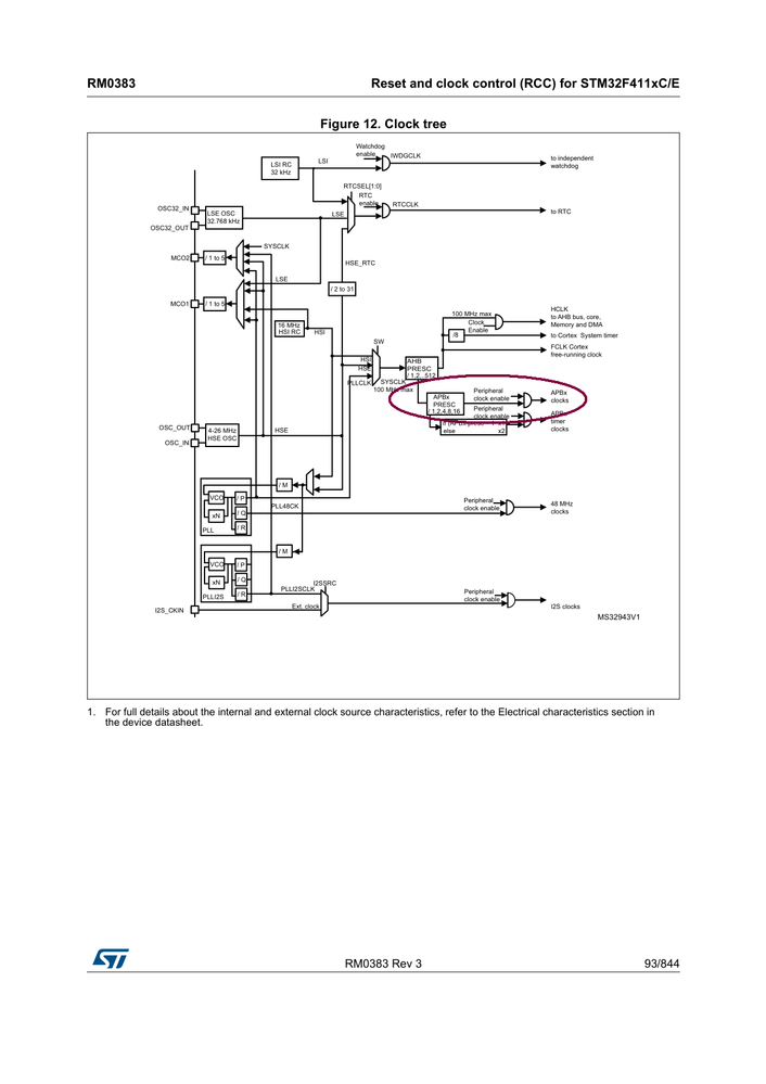

As for the 3rd screenshot - I saw that when I did research - it does not answer the posted question, which APB clocks which SPI.
Again thank you very much for the block diagram - very helpful.
