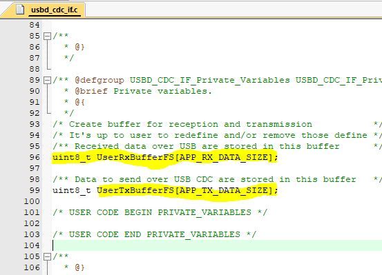

2019-05-07 12:54 PM
Hi
Yes , this is a higher layer buffer allocated by user.
I put a Photo for this in the previous post. Very easy to check.
This buffer is different than in the first answer posted.
I know it seems irrelevant with this case but the uint8_t UserTxBufferFS[APP_TX_DATA_SIZE]; is on stack and as global, allocated first.
So Stack continues growing down and conflicts with upper heap space.
