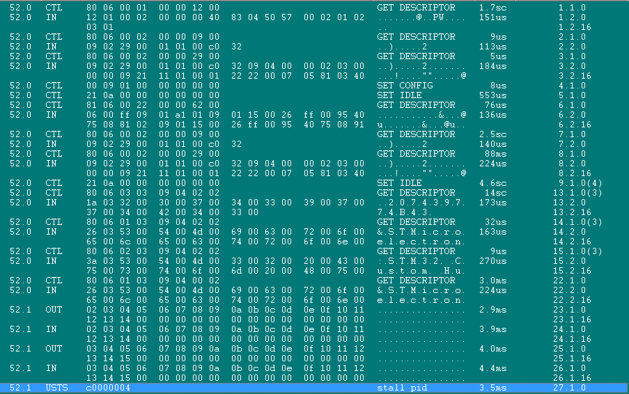

2022-05-25 4:17 AM
I can see USTS c0000004 when two packets are sent and received.
2022-05-25 10:58 PM
Currently "USBD_LL_PrepareReceive" is called in "USBD_CUSTOM_HID_DataOut". I think it should be called in "USBD_CUSTOM_HID_DataIn" if data needs to be sent "USBD_CUSTOM_HID_SendReport" called in "CUSTOM_HID_OutEvent_FS".
