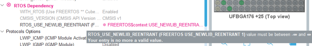

Hello, I have problems configuring a STM32F207 with Ethernet and LwIP and FreeRTOS. I have activated RTOS_USE_NEWLIB_REENTRANT in the FreeRTOS settings but still an error message appears in the LwIP settings. How can I fix this?

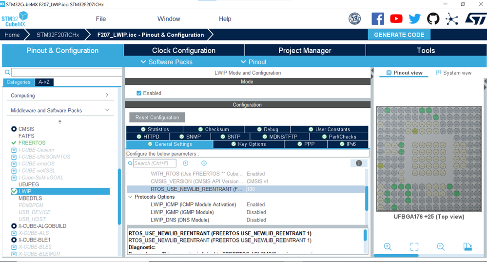

_legacyfs_online_stmicro_images_0693W00000bigtnQAA.pngAfter Enabling RTOS_USE_NEWLIB_REENTRANT in the FreeRTOS settings you need to give it a value .
Thx
