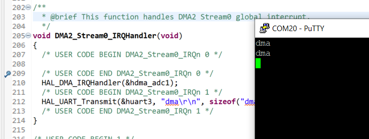

But now im trying to use stm32f207 (NUCLEO-f207zg) , the DMA works one time(first channel) and dies.
DMA interrupt IRQ is only triggered 2 times (mid transfer and transfer completed of the first adc channel)
What am i missing , what is different in stm32f207?

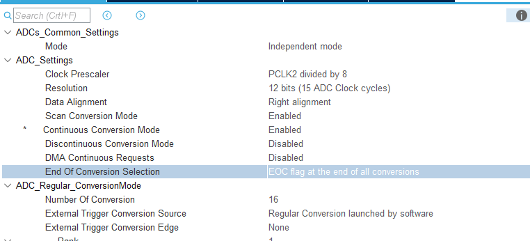

Javier,
Look at the ADCx_CR2.DDS bit description in RM. I don't use CubeMX so you have to find how this maps there, I'd guess it is the DMA Continuous Requests tickbox.

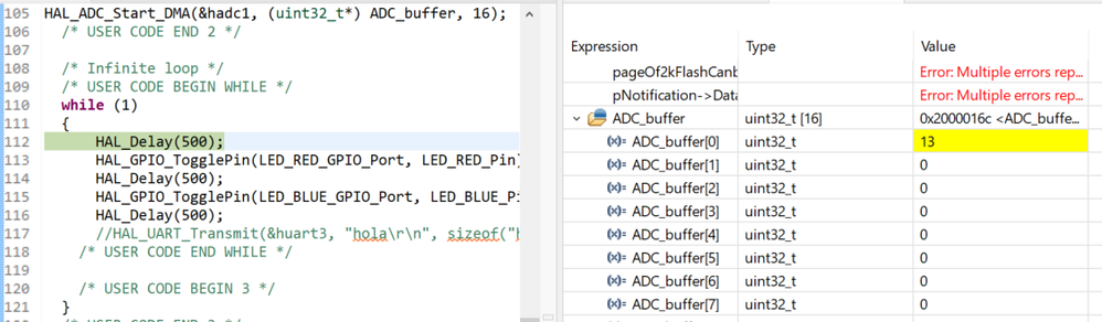

I am debugging that ADC1->CR2.DDS register but it appears to be set to 0 the whole time

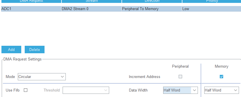

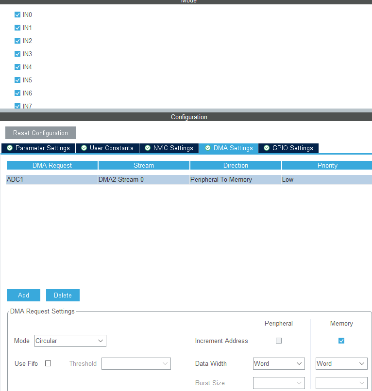

/* ADC1 DMA Init */
/* ADC1 Init */
hdma_adc1.Instance = DMA2_Stream0;
hdma_adc1.Init.Channel = DMA_CHANNEL_0;
hdma_adc1.Init.Direction = DMA_PERIPH_TO_MEMORY;
hdma_adc1.Init.PeriphInc = DMA_PINC_DISABLE;
hdma_adc1.Init.MemInc = DMA_MINC_ENABLE;
hdma_adc1.Init.PeriphDataAlignment = DMA_PDATAALIGN_HALFWORD;
hdma_adc1.Init.MemDataAlignment = DMA_MDATAALIGN_HALFWORD;
hdma_adc1.Init.Mode = DMA_CIRCULAR;//<----------------------------------------------------:D
hdma_adc1.Init.Priority = DMA_PRIORITY_LOW;
hdma_adc1.Init.FIFOMode = DMA_FIFOMODE_DISABLE;

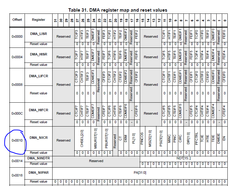

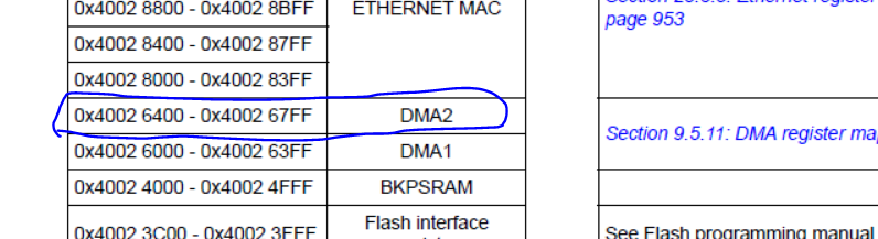

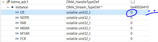

hdma->Instance->CR = tmp;// <---- hdma->Instance->CR doesnt get tmp value for some reason, it remains 0I cannot change the value manually in the Debugger Expressions window.......
Something is preventing this memory to being written, something is preventing the init code to write the configurations in the DMA2 Stream0 registers.That memory addr 0x40026410 happens to be where DMA2 Stream 0 peripheral is mapped, as expected in my cubeMX configuration.
I just opened a question about this https://community.st.com/s/question/0D53W00001B0menSAB/why-cant-i-write-into-mem-0x40026410

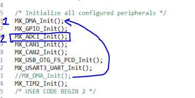

2021-11-04 3:58 AM
As @Bruno_ST pointed out here all this buzz happened because cubeMx tries to config the DMA before its clock is enabled.
I just changed the order of how DMA and ADC are initialiced and it works now.
