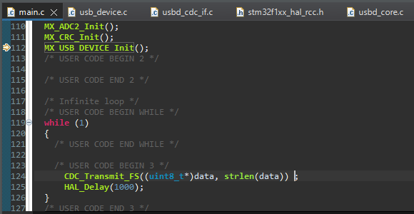

2023-05-03 9:00 AM
Also, generally, if you call Transmit from the main loop, the USB will sooner or later hang.
