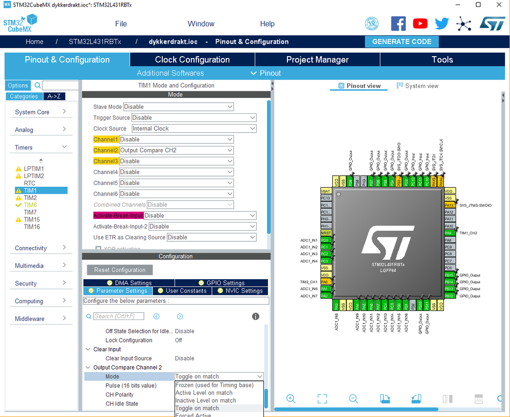

I re-configure some TIM1 parameters (see attached picture):

Regarding TIM1 used as PWM generator while ADCs are in use:
I want to add a feature to my project: A need a fixed/constant 200kHz output-pulse.
I try to configure TIM1-CH2 (PA.09) for this purpose, but no pulse is generated (tried lots of “TIM1-variations�?).
Q3: Can I use TIM1-CH2 (PA.09) for this “PWM-purpose�? when I already are using ADC1 channel 1-16 (I assume the ADC’s are using TIM1 for some purposes)?

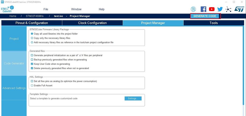

2019-02-13 6:40 AM
In the right panel, there is "Generate code" button to generate your project.
Kind Regards,
Imen.
