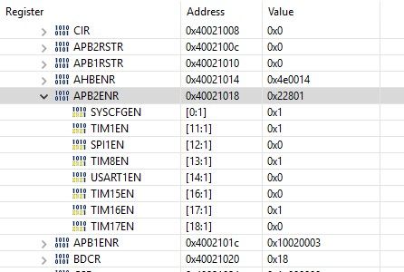

The test is the following: if you see in the reference manual on page 151 the register RCC_APB2ENR you will see that there is bit 20 (TIM20EN) to enable the clock at TIM20. Instead with TrueStudio, if you enter debug mode, then open the internal registers, and display RCC_APB2ENR, you will see that bit 20 (TIM20EN) is missing, so it is impossible to enable the clock to TIM20:
So STM32CubeMX is right. The fault could be in TrueStudio which displays the TIM20 register even if it is not really available.

Missing bit in an IDE proves nothing. It may be a bug in the IDE.
Try to write 0xFFFFFFFF into APB2ENR, then read it back - that reveals which bits are implemented.
