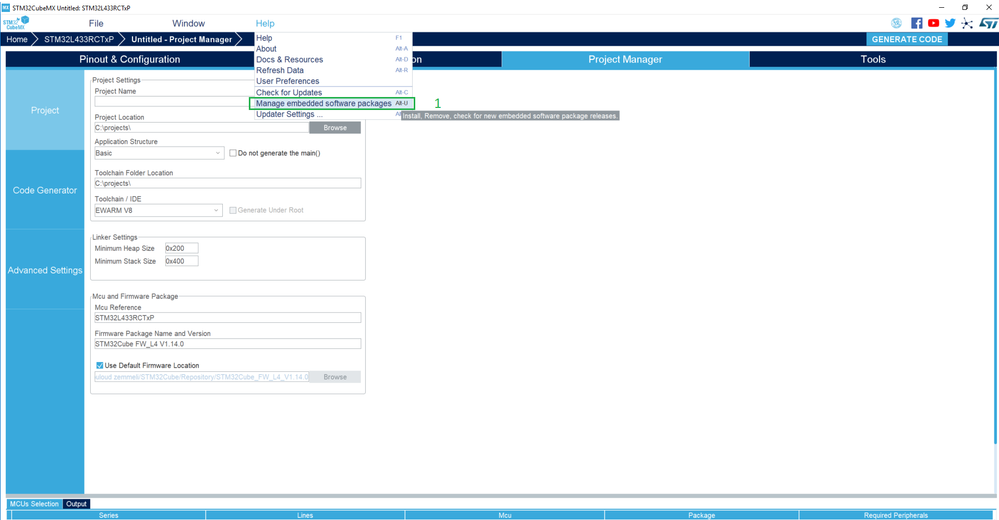

1- Select "Manage Embedded Software Packages" under Help

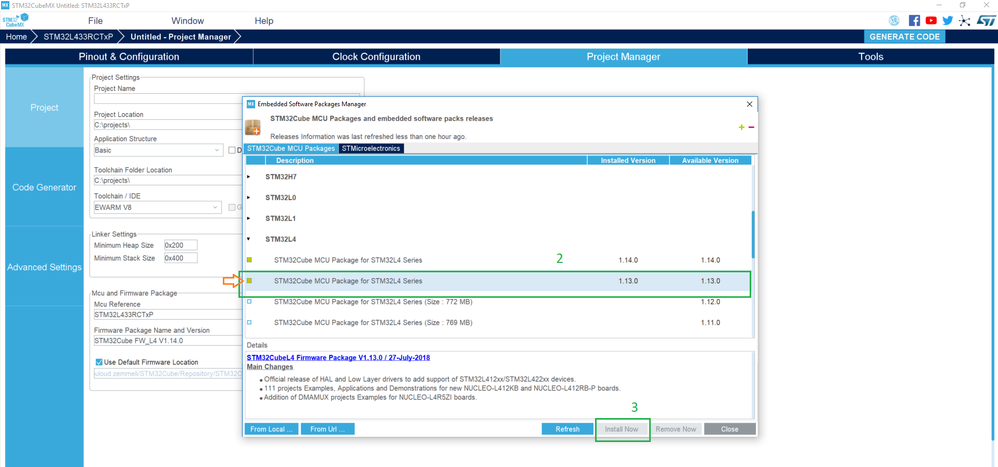

2019-05-27 1:15 AM
2- check the small box
3- Select Install Now

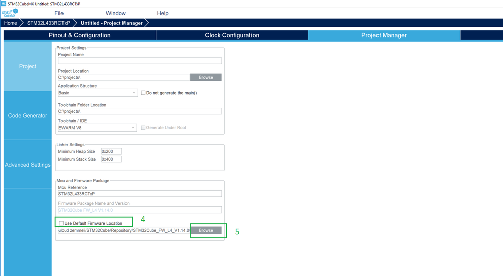

2019-05-27 1:19 AM
Wait until the install finish then :
4- Uncheck the small box beside Use Default Firmware Location
5- Select "Browse"

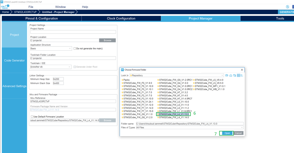

2019-05-27 1:23 AM
6- Select STM32Cube_FW_L4_V1.13.0
7- Select Open

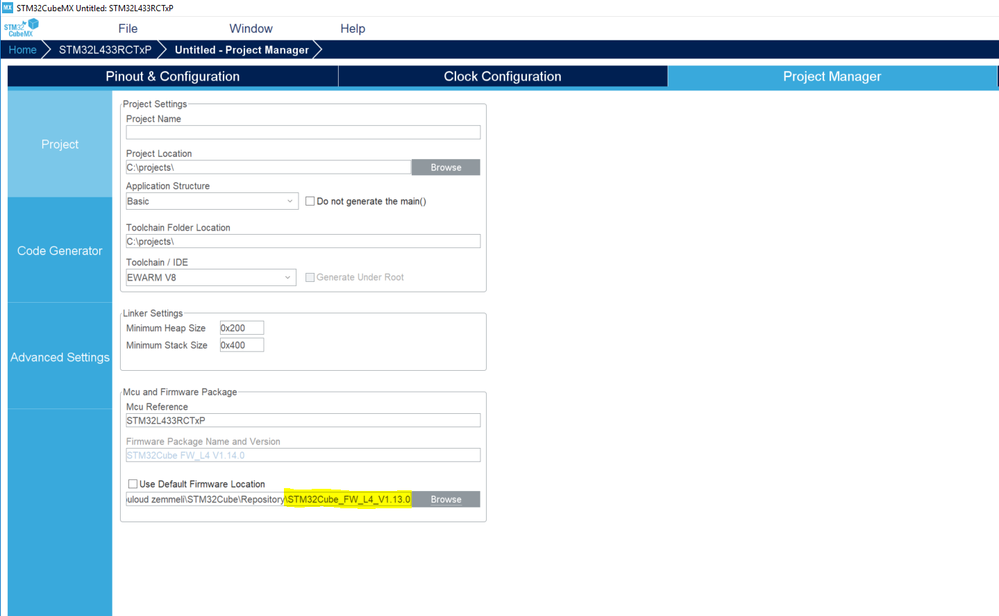

2019-05-27 1:24 AM
that's all.
