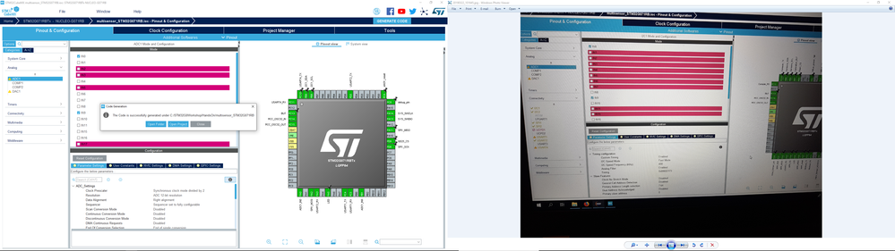

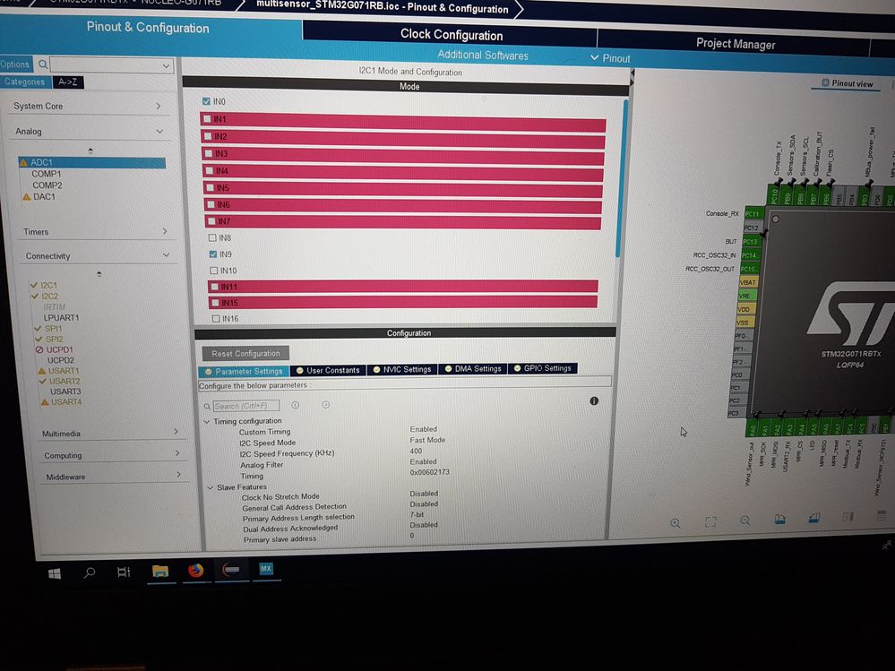

2019-03-22 2:20 AM
The cube is a evident problem, You can see when you turn something into a problem with ADC. See I have ADC turned on and the configuration from I2C is displayed
