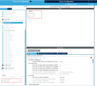

Version: STM32CubeMX 6.16.0
MCU: STM32WB15CCU6
Untilities Sequencer can not enabled, which says connectivity WM's not enabled.
But no "WM's" in connectivity page.
How to enable sequencer?

2025-11-26 1:06 AM
I'm already enabled BLE function, sequencer still in gray.
And without these seq files, STM32CubeIDE build failed.

2025-11-26 1:36 AM
2025-11-26 1:43 AM

2025-11-26 1:48 AM
I found after use AZRTOS_WB, sequencer is disabled. If not use AZRTOS, sequencer is OK.
