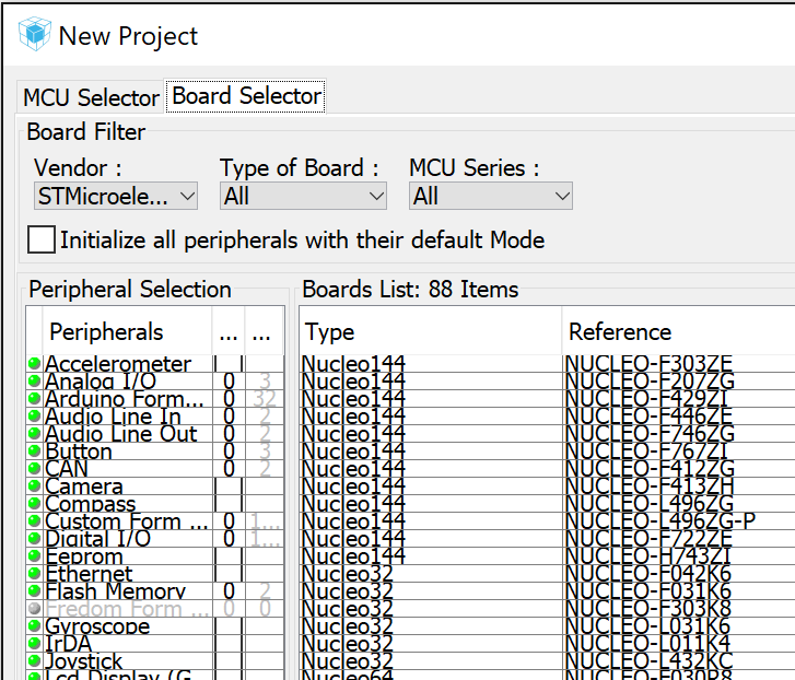

2017-08-04 4:46 PM
Imen, it has just over 7 months since you said that you would get back with a response ASAP.
This is a screenshot from my CubeMX application which is currently at 4.22.0. What I and the community would like to know is when this issue will be fixed because while it is usable, it is not optimal.
Is this issue able to be fixed? Is it a problem with the underlying Java libraries? The community would like answers and explanations.
If the problem is within the CubeMX application itself, it should not be difficult to fix I would imagine. If the problem is within the Java UI libraries then this should be communicated.
Are there any plans to open source this application, to place it on GitHub and maybe a few members of the community can pitch in and fix the problem.
Thank you for your time.

2017-08-10 8:14 PM
The problem stems from the inability for the Swing API (The Java library that handles the GUI) to properly scale the controls to fit the text. While <CTRL> + Mousewheel does solve the issue to some degree, the individual elements within the clock configurator don't scale properly.
If you look at my post above, you will notice that the dividing lines for the board list don't scale properly to fit the text which makes it difficult to read. I do have a solution which works that is detailed further down. This is a rather drastic approach and consequently affects all java applications.
There might be a way to limit this workaround to just the CubeMX application by making a copy of the javaw.exe application and applying the workaround to just the copy. This copy could then be used to explicitly run the CubeMX software. I have not tried this but if I do go ahead with this and it works I will update my post further down to detail what I did.
