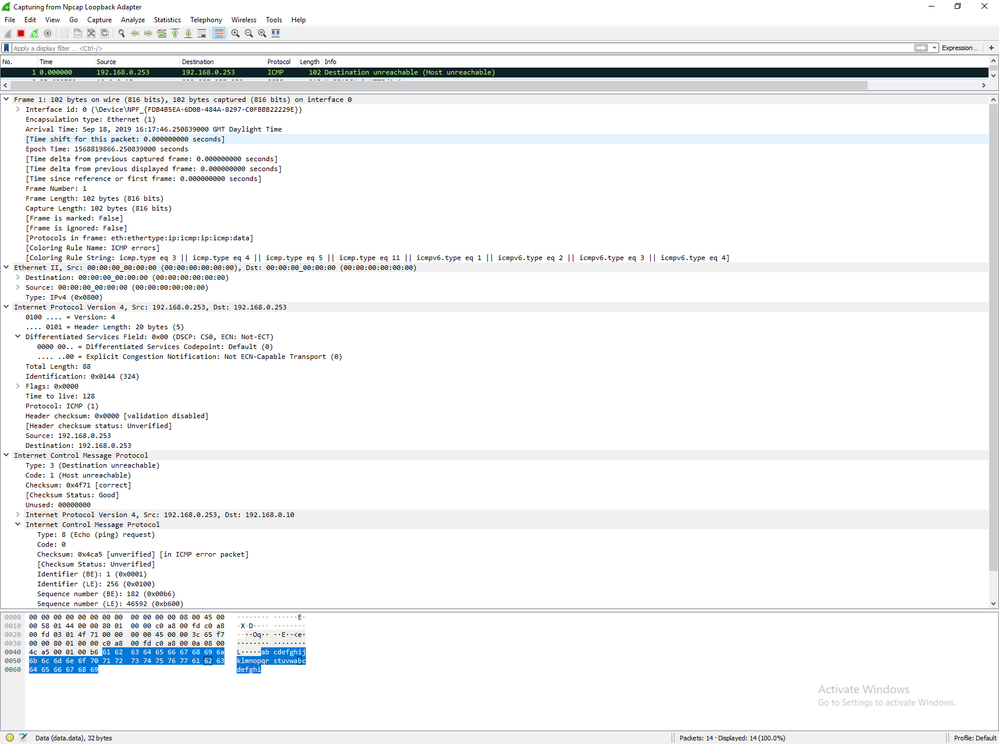

I am not experienced in using the network sniffer , when I ping the board (ip address 192.168.0.10) from my pc ( pc id addr 192.168.0.253) - I see host not reachable packet shown in wireshark tool. Does it give any clue ? (Attached the screenshot)
No, unfortunately not much. Just that your board does not answer ARP requests.
If you use LWIP customized by ST, ARP replies should be automatically sent by the ethernet controller.
