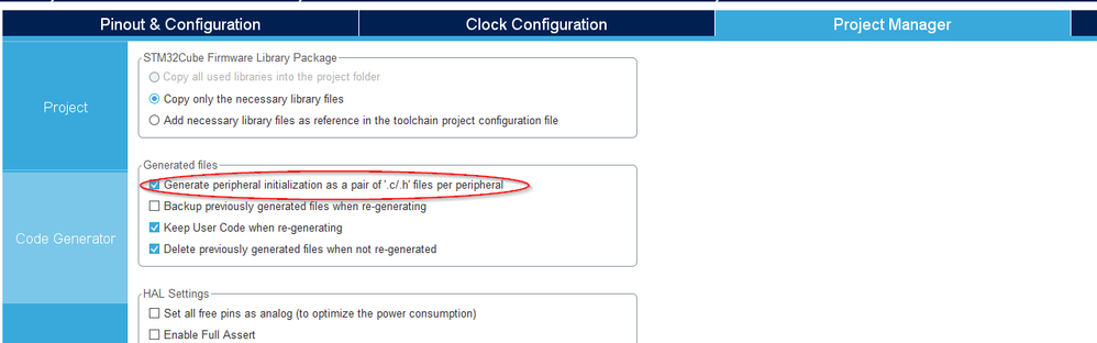

It appears the fault lies in CubeMX code generation.
My code and the github code follow the same settings but there is an option in the code generation which I found was different across the two. At first glance the code appears to be the same, with various init code shuffled around... But nevertheless something is different enough to break things.
Enabling the following setting is required for a ping to work out of the box with both FreeRTOS and LWIP enabled,
