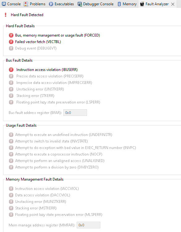

I run a generated code from stm32cube IDE with LL drivers, and the debug process stops.
2022-04-26 2:58 PM
Did it hard fault? What do the hard fault registers indicate? Is HSE_VALUE used and set correctly?
Known good hardware or a custom board?

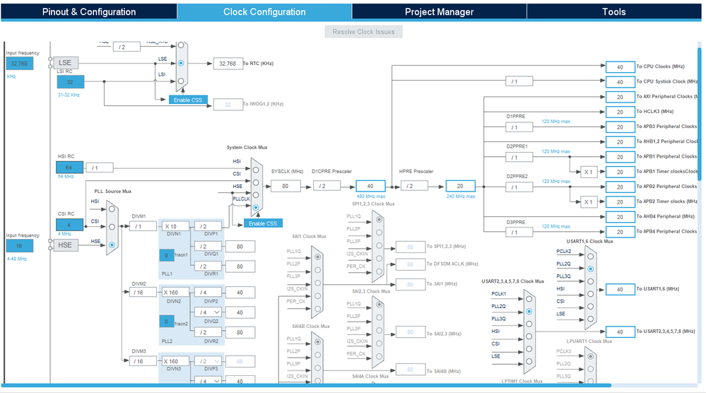

HSE is 16Mhz, it is configured correctly in clock
It is a custom hardware.

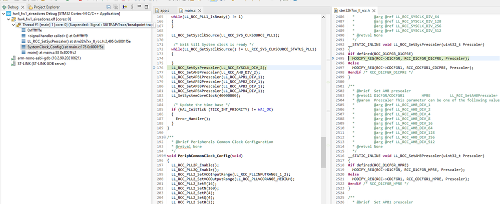

LL_RCC_SetSysClkSource(LL_RCC_SYS_CLKSOURCE_PLL1);
should be set AFTER
LL_RCC_SetAHBPrescaler(LL_RCC_AHB_DIV_2);
Intermediate AHB prescaler 2 when target frequency clock is higher than 80 MHz
