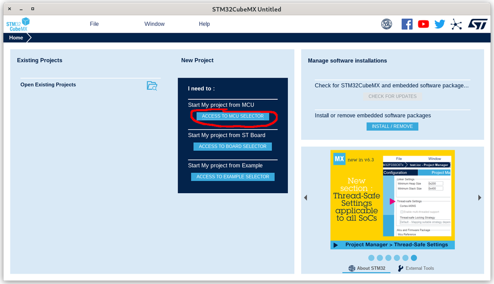

When I click ACCESS TO MCU SELECTOR, the console prints :

2023-01-18 2:46 AM
Hello @yl.1
Please check this LINK in order to download the latest version of CubeMX 6.7.0
Could you please re-test with it and check if the issue persists.
I will be waiting for your feedback.
Thx
Ghofrane
2023-10-13 8:36 PM - edited 2023-10-13 8:44 PM
It happens when two monitors are connected and a certain configuration.
I have 3000x2000 laptop monitor with 200% scale and a second 1920x1080 with 100% scale. The second monitor is set as main.
Setting laptop as main fixes the problem temporarily.
I am on Windows.
