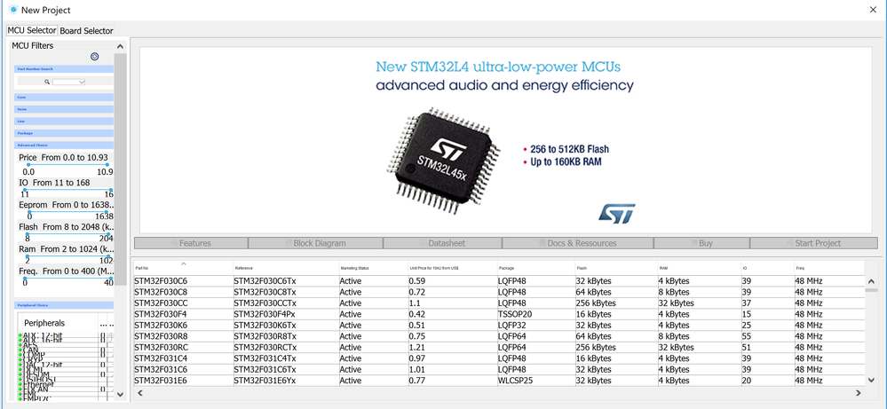

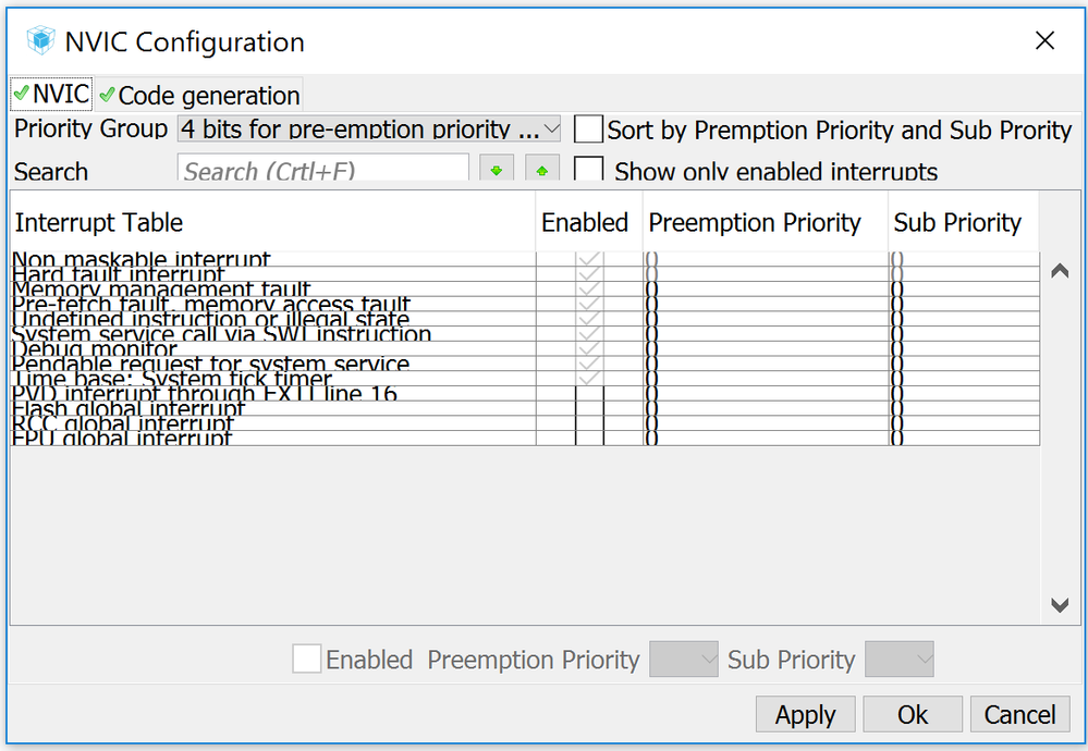

I think the STM32CubeMX code generator has a big problem with screen resolution. I'm using a laptop with 4K display, so my CubeMX appears like following screenshots, which are annoying in many cases: Almost half of most table rows appear vertically, the texts sometimes are too small or too large and so on:
Can this problem fix?

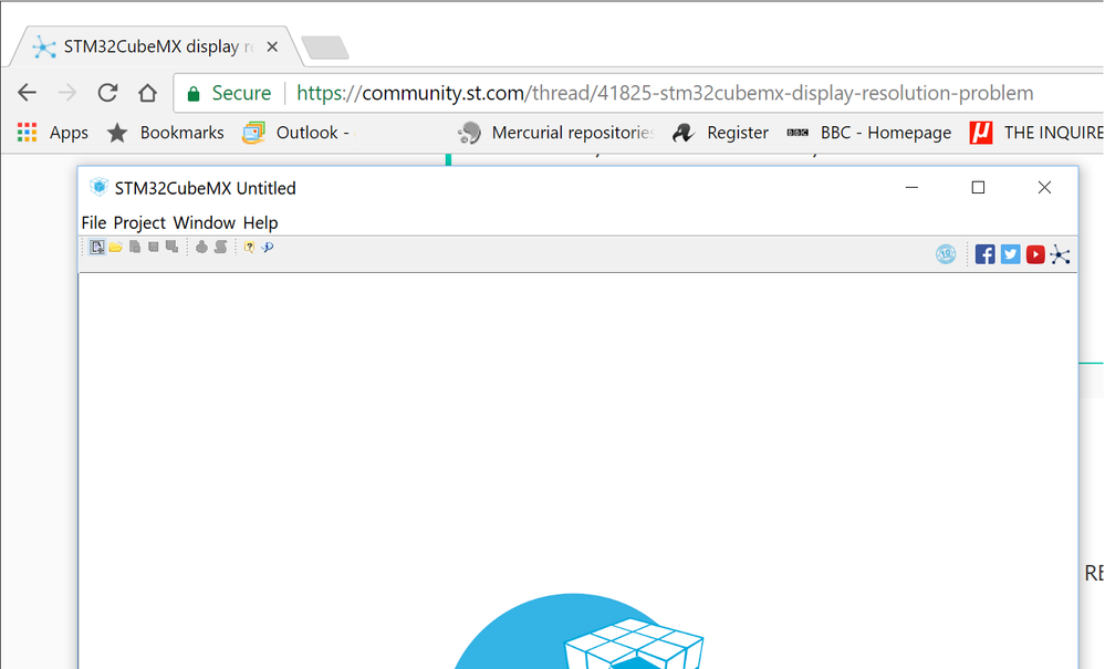

2017-07-10 10:28 AM
I also use a 4K display and find the cube output difficult to read. Please consider scaling the font sizes by real physical size, or allow us to set a larger font size. Also, the toolbar icons are stupidly small. I have attached an image illustrating how the icons are too small... In our own Windows software we calculate the physical size of the fonts and icons taking into account the scaling set for the monitor. You need to use icons of at least 32x32 if not 48x48 or more to work with 4K displays. I run with scaling set to 175%.
Perhaps you could get someone in the development team to try to use a 28'' 4K display and see how they cope with the tiny fonts and icons...

Hello CubeMX developers
I am sorry to be back with this issue, but 4K screens and CubeMX do not go together. We are here more than two dozen people facing this issue almost daily. No way to project educational slides with this kind of nonstandard dialog windows:
or speedbuttons that are as tiny as 2x2mm on some screens and not decipherable.
To ST HMI developers: Please keep in mind, that the first front-end impression to critical students may make it difficult for the instructor to pass a positive message about CubeMX to students.
Thank you very much for a soon release after 4.22.1 of software where listbox line height calculation and list item font size is being computed by the underlying native environment API and not apparently by the development tool which fails in this respect.
