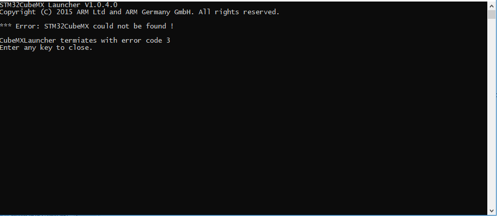

I am trying to create a simple project on Keil and add some components via "Run Time Environment". I select necessary components then it tries to run STM32CubeMX which is also checked under "Device" tab. Anyhow, I get an instant error says that " *** Error STM32CubeMX could not be found!" by STM32CubeMxLauncher.exe
I tried to reinstall BSP packages of my board(Nucleo-STM32F030R8), reinstalled CubeMX(also tried older versions of it), run Keil in admin mode, ,compatibility mode. But no luck.
What I have noticed that when the installer finishes installing CubeMX, it does not create any shortcut on desktop but completes the installation without any error. I look add/remove programs under contral panel, it is not listed in installed programs.
I think there is a problem about installation of CubeMX. System does not see it then STM32CubeMXLauncher.exe cant find it.
My OS : Windows 10
Keil Version : MDK-Lite Version 5.28
Cube MX : 5.21
Any idea how can I fix this issue ?
