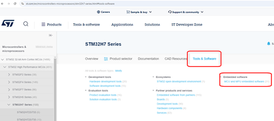

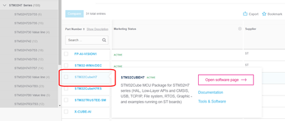

2024-10-22 3:02 AM
Now we know the family ...
Go to the 'Tools and Software' tab, click 'MCU and MPU embedded software':
You want the STM32CubeH7 pack:
The User Manual is on the software page, 'Documentation' tab:
https://www.st.com/en/embedded-software/stm32cubeh7.html#documentation
Don't know why that isn't directly linked from CubeMX - @STTwo-32 ?

2024-10-22 2:49 AM
"it will be linked from the Product Page for the family"
Where? On the website? Can not find it there.
https://www.st.com/en/microcontrollers-microprocessors/stm32h7-series.html
2024-10-22 3:02 AM
