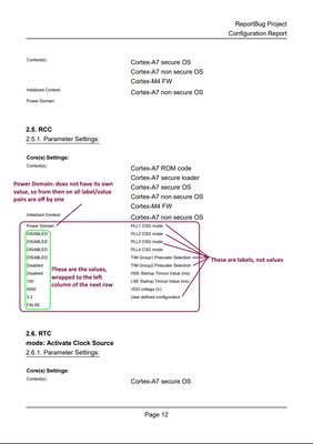

The otherwise excellent STM32CubeMX tool has a bug in its Configuration Report output (reached via the File > Generate Report command). In the Peripherals and Middlewares Configuration section of the report, the left and right columns of the output are reversed or (more likely) line-wrapped.
See attached screen shot for an example -- this continues for many pages.

@Issamos , @Sarra.S : here is a summary of the findings.
The Report generator creates an off-by-one label/value mismatch after each "Power Domain:" label in the report. The "Power Domain:" label itself never has a value (which is probably the source of the problem), causing subsequent label/value pairs to be shifted one position, such that the labels end up in the right-hand column and their values in the left-hand column on the next line. See this screen shot:
Off-by-one label/value errors after Power Domain: label without its own value

This was generated with STM32CubeMX 6.9.0 for an MCU type STM32MP157CAD3, with no changes after the new project was created. Use File > Generate Report to create the report.
The problem manifests itself after each "Power Domain:" label throughout the report. The full PDF report generated from this project is also attached for further inspection.

Hello @tarmasr,
I have reproduced the same issue by starting a new project from scratch with your configurations!
Thank you for bringing this to our attention, I have reported this issue internally (161430: Internal ticket number)
