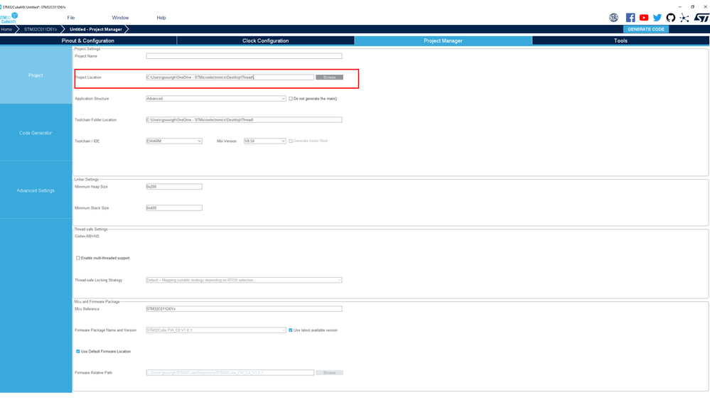

2023-05-16 3:28 AM - edited 2023-11-20 5:21 AM
Hello @PKova.1
Concerning the issue mentioned above try to double-check the file or directory path: Verify that the path you provided is correct and that the file or directory you are trying to access actually exists.
I will be waiting for your feedback.

2023-05-16 3:48 AM
Yes, everything is correct. The directory path exists, I know it because the directory Core is updated correctly by Code generation process.
