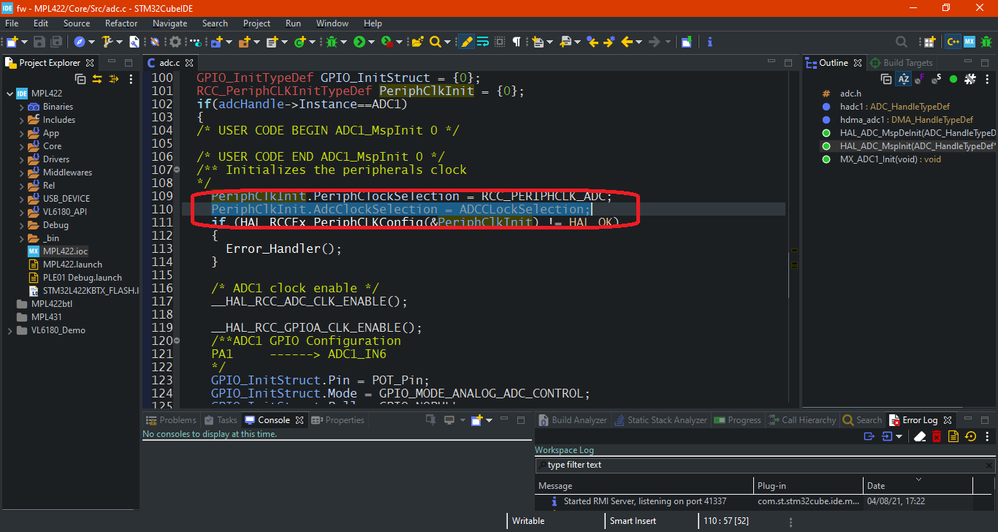

I just updated STM32CubeMX from version 6.2.0 to 6.3.0 which configured the adc.c file by inserting the line of code highlighted in the figure. The compiler gives an error recognizing that the 'ADCClockSelection' parameter does not exist. How can this error be corrected?

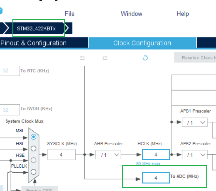

I am attaching the .ioc file and the ADC.c file written by the STM32CubeMX.It should be clarified that I use the STM32L422KBT6 microcontroller. I saw that the CubeMX writes in the ADC.c file, at line 110, the following code:
PeriphClkInit.AdcClockSelection = ADCCLockSelection;

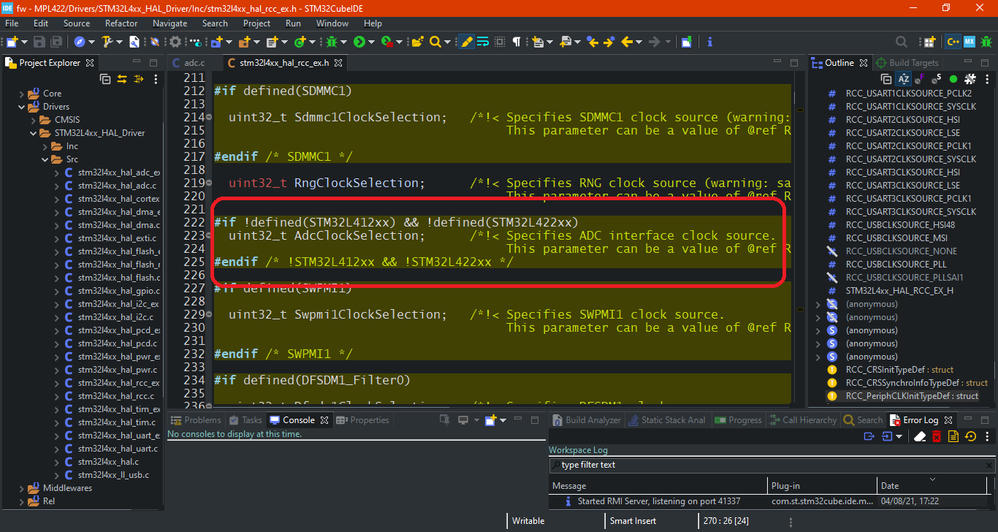

However, in the PeriphClkInit structure, the AdcClockSelection entry is not defined. In fact, I checked in the file "stm32l4xx_hal_rcc_ex.h" where the entry "AdcClockSelection" is defined, it is not declared as STM32L412xx and STM32L422xx do not need to select the clock source. I am attaching the figures of my code.

Hello @elb-lab ,
Thanks for your feedback and for the detailed report.
You're absolutely right. In fact, referring to STM32L4 Reference manual, the ADCs clock which is derived (selected by software) from one of the following
sources:
Thus, as you've mentioned, STM32L412xx and STM32L422xx do not need to select the clock source.
However the HAL_ADC_MspInit function is wrongly generated using the latest 6.3.0 version of STM32CubeMX.
As I've already mentioned, no problem was detected with the previous STM32CubeMx version 6.2.1. I assume that the HAL_ADC_MspInit function used to be correctly generated:
