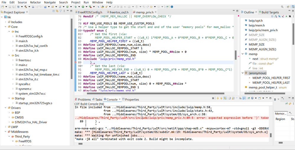

Hello @Simon
I am using STM32CubeMX 6.17.0.
After generating the code with your IOC configuration, I encountered the following error, which is currently under investigation:
In file included from ../Middlewares/Third_Party/LwIP/src/include/lwip/memp.h:58,
from ../Middlewares/Third_Party/LwIP/src/include/lwip/stats.h:43,
from ../Middlewares/Third_Party/LwIP/system/OS/sys_arch.c:38:
../Middlewares/Third_Party/LwIP/src/include/lwip/priv/memp_priv.h:89:5: error: expected expression before ')' token
89 | ) ,
arm-none-eabi-gcc "../Middlewares/Third_Party/LwIP/src/netif/ppp/chap-md5.c" -mcpu=cortex-m7 -std=gnu11 -g3 -DDEBUG -DUSE_PWR_DIRECT_SMPS_SUPPLY -DUSE_HAL_DRIVER -DSTM32H725xx -c -I../Core/Inc -I../LWIP/App -I../LWIP/Target -I../wolfTPM -I../Middlewares/Third_Party/LwIP/src/include -I../Middlewares/Third_Party/LwIP/system -I../Drivers/STM32H7xx_HAL_Driver/Inc -I../Drivers/STM32H7xx_HAL_Driver/Inc/Legacy -I../Middlewares/Third_Party/FreeRTOS/Source/include -I../Middlewares/Third_Party/FreeRTOS/Source/CMSIS_RTOS_V2 -I../Middlewares/Third_Party/FreeRTOS/Source/portable/GCC/ARM_CM4F -I../Drivers/CMSIS/RTOS2/Include -I../Drivers/BSP/Components/lan8742 -I../Middlewares/Third_Party/LwIP/src/include/netif/ppp -I../Drivers/CMSIS/Device/ST/STM32H7xx/Include -I../Middlewares/Third_Party/LwIP/src/include/lwip -I../Middlewares/Third_Party/LwIP/src/include/lwip/apps -I../Middlewares/Third_Party/LwIP/src/include/lwip/priv -I../Middlewares/Third_Party/LwIP/src/include/lwip/prot -I../Middlewares/Third_Party/LwIP/src/include/netif -I../Middlewares/Third_Party/LwIP/src/include/compat/posix -I../Middlewares/Third_Party/LwIP/src/include/compat/posix/arpa -I../Middlewares/Third_Party/LwIP/src/include/compat/posix/net -I../Middlewares/Third_Party/LwIP/src/include/compat/posix/sys -I../Middlewares/Third_Party/LwIP/src/include/compat/stdc -I../Middlewares/Third_Party/LwIP/system/arch -I../Drivers/CMSIS/Include -I../Middlewares/Third_Party/wolfSSL_wolfTPM_wolfTPM/wolftpm/ -I../wolfSSL -I../Middlewares/Third_Party/wolfSSL_wolfSSL_wolfSSL/wolfssl/ -O0 -ffunction-sections -fdata-sections -Wall -fstack-usage -fcyclomatic-complexity -MMD -MP -MF"Middlewares/Third_Party/LwIP/src/netif/ppp/chap-md5.d" -MT"Middlewares/Third_Party/LwIP/src/netif/ppp/chap-md5.o" --specs=nano.specs -mfpu=fpv5-d16 -mfloat-abi=hard -mthumb -o "Middlewares/Third_Party/LwIP/src/netif/ppp/chap-md5.o"
make: *** [Middlewares/Third_Party/LwIP/system/OS/subdir.mk:19: Middlewares/Third_Party/LwIP/system/OS/sys_arch.o] Error 1
make: *** Waiting for unfinished jobs....
"make -j8 all" terminated with exit code 2. Build might be incomplete.
13:03:08 Build Failed. 3 errors, 0 warnings. (took 56s.577ms)
I have no build errors related to FreeRTOS, so I’m not sure what I’m missing. Could you please share a screenshot of the issue you described, where Middleware/Third_Party/FreeRTOS/Source/CMSIS_RTOS_V2/freertos_os2.h is not updated and causes a build error?

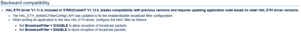

So, I had to manually install a newer ARM.CMSIS pack 5.9.0 and then it built and the app mostly works, except now the ethernet functionality doesn't work. ARP packets are not getting through to the etharp_input function. I found a rather obscure breaking change mentioned in the release notes.
The suggested solution here is so simplistic that it is not useful. How is this meant to be fixed in user application code?
