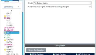

Hello @Peter Allnutt
I've been able to configure the 3 SPI interfaces on the STM32L476RG MCU and the Nucleo board using this MCU.
Could you share more details about your issue (with screenshots and description if possible).

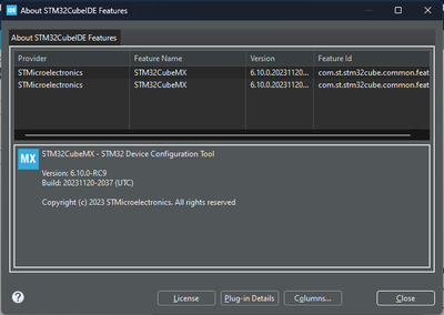

2024-02-19 8:54 AM

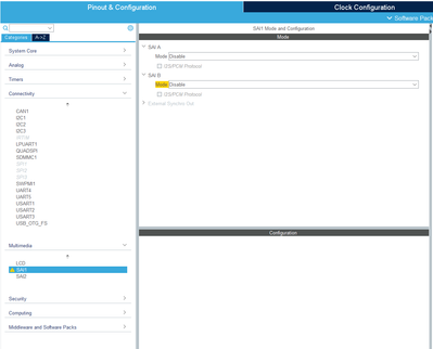

Thanks both for your responses. As I said if I use STM32CubeMX 6.9.2 it works and I see what you show above. My STM32CubeIDE embedded CubeMX is version 6.10.0. Here is what I see after simply creating a new STM32 Project based on the Nucleo board within STM32CubeIDE
I've expanded the SIA configuration so you can see nothing is enabled there.

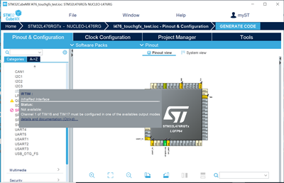

2024-02-19 10:39 PM
Everything looks fine on my side. could you share the message that appears when you put the curser on an SPI interface like this:
Best Regards.
STTwo-32
