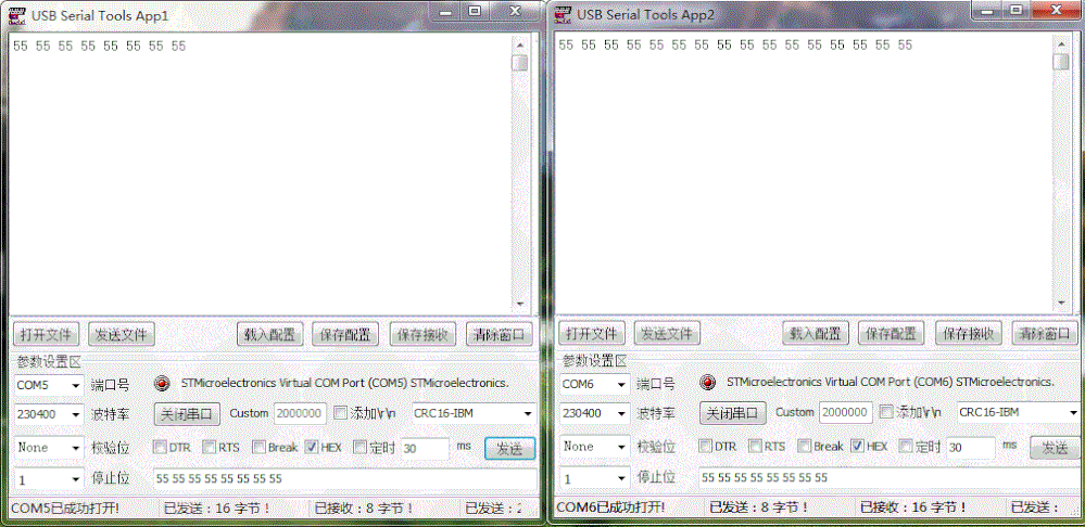

2015-05-21 11:20 PM
but baud ratechange to 19200 bps, all receive data and number is
correct

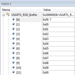

! when baud rate up to 1000000 bps , into this code and not exit! Of course, baud rate is 230400bps,hardware have noproblem 。 if(huart->ErrorCode != HAL_UART_ERROR_NONE) { /* Set the UART state ready to be able to start again the process */ huart->State = HAL_UART_STATE_READY; HAL_UART_ErrorCallback(huart); } USE_STDPERIPH_DRIVER, USB_Dual_CDC, two MAX3232, hardware test is ok:2015-05-22 4:40 AM
MX_USART1_UART_Init(); MX_USART2_UART_Init(); /* USART2 init, but not send */ /* USER CODE BEGIN 2 */ HAL_UART_Receive_IT(&huart1, &USART1_RXD_Buffer[0],USART1_RX_LEN); //HAL_UART_Transmit_IT(&huart2,&USART2_TXD_Buffer[0],USART2_TX_LEN); /* not run ,but still usart1 receive a 0xF8 */ /* USER CODE END 2 */We’re moving the ST Community to a new platform to give you a better and more reliable community experience.
