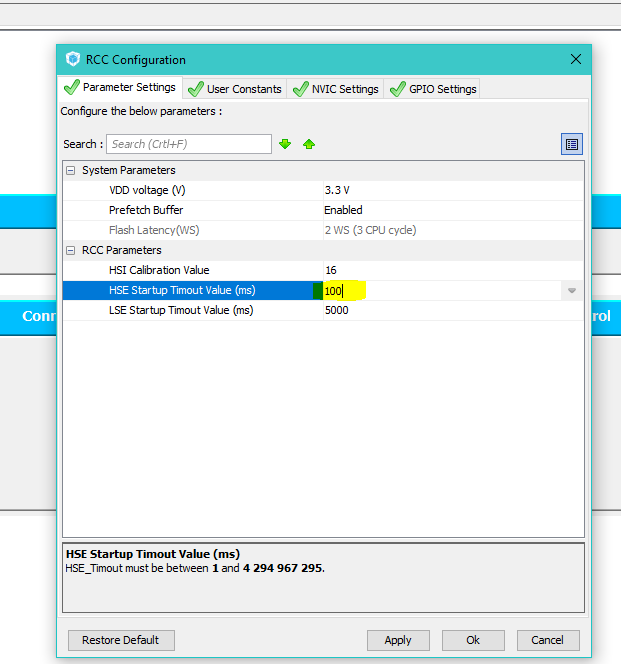

Your code is working fine in my cheap ebay board with f103c8t6
Try to increase the timeout of ''HSE clock ready'' like this
If you put eg 5000 and you have the same error.. the oscillator is problematic(crystal capacitors resistors)

I tried HSE Startup timeout Values to 100, 200 and 500; But same error occurred. May be this error has
