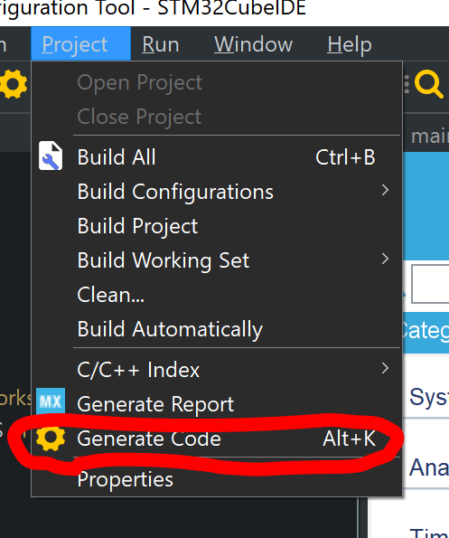

There should be a "generate code" button or menu option.
I don't think CubeMX can generate a C++ project directly, but you can certainly convert it to C++ after creation. Things may have changed recently.
Edit:
And it appears you can create C++ projects directly now, but it still names the main file "main.c". You can rename it to main.cpp and it will work. I just checked this.

Thanks, TDK - I did find the "Generate code" in STMCube32IDE, but wasn't sure if that was the right way to proceed as STM32CubeMX still seemed to be waiting for user input. I'm accustomed to seeing "GENERATE CODE" on the upper right of STM32CubeMX (when I run it directly, to create a new project for subsequent use in STM32CubeIDE), but that ("GENERATE CODE") button isn't rendered when STM32CubeMX is running as a child of STM32CubeIDE in the path I followed in the first post.
I also just realized I'm using one older version STMCube32MX (6.4.0 vs 6.5.0) at STMCube32IDE (1.8.0 vs 1.9.0). Before I go any further, I'll get the updates done.
