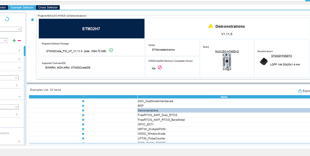

I'm trying to use STM32CubeIDE to create a project for this board from the list of "Examples Selector". I picked "Demonstrations" as seen in the picture. I don't see a ".ioc" file and when I try to build I get these errors:

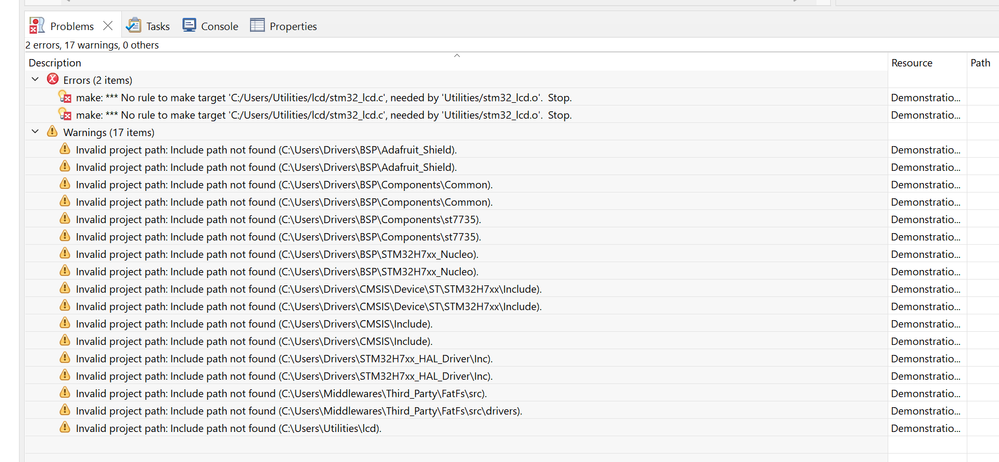

Description Resource Path Location Type
make: *** No rule to make target 'C:/Users/myUserName/STM32W/Demonstrations/STM32CubeIDE/Utilities/lcd/stm32_lcd.c', needed by 'Utilities/stm32_lcd.o'. Stop. Demonstrations_CM4 C/C++ Problem
make: *** No rule to make target 'C:/Users/myUserName/STM32W/Demonstrations/STM32CubeIDE/Utilities/lcd/stm32_lcd.c', needed by 'Utilities/stm32_lcd.o'. Stop. Demonstrations_CM7 C/C++ Problem

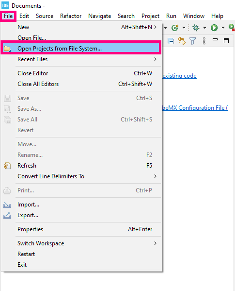

2- Click File-->Open Projects from File System as shown in the below figure

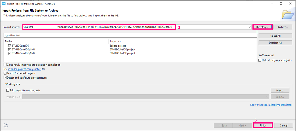

3- Browse the Demonstrations\STM32CubeIDE project file located in this path "STM32Cube_FW_H7_V1.11.0\Projects\NUCLEO-H745ZI-Q\Demonstrations\STM32CubeIDE" as shown in the below figure

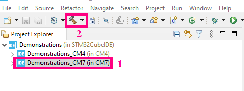

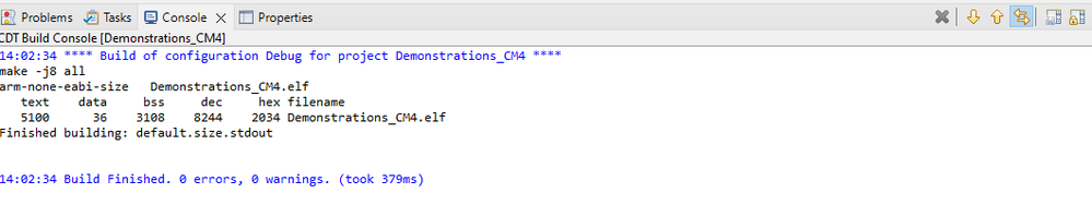

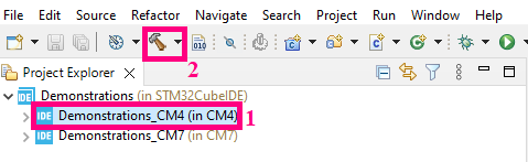

4-Build the Demonstrations_CM4 project as shown in the below figure

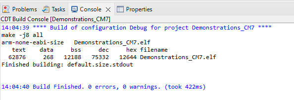

5-Build the Demonstrations_CM7 project

I just saw that exclamation symbol next to the name. I tried to make the project again and I notice a message related to that symbol in the upper left corner that says:
"Selected example is still in development and may not be fully functional"
I selected another demo (GPIO_EXTI) for the board and this one doesn't have a ioc file either but it builds without errors.

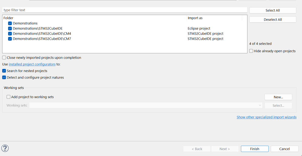

How about instructions how to import this into cubeIDE? I tried to "import project" from the information center screen but what I got didn't work. Thanks:

2023-05-17 1:56 PM
Ok that built without errors. Thanks. Before I mark it as answered, one last thing ... there is still no ioc (visual configuration) file in the project. How do I get that? Thanks
